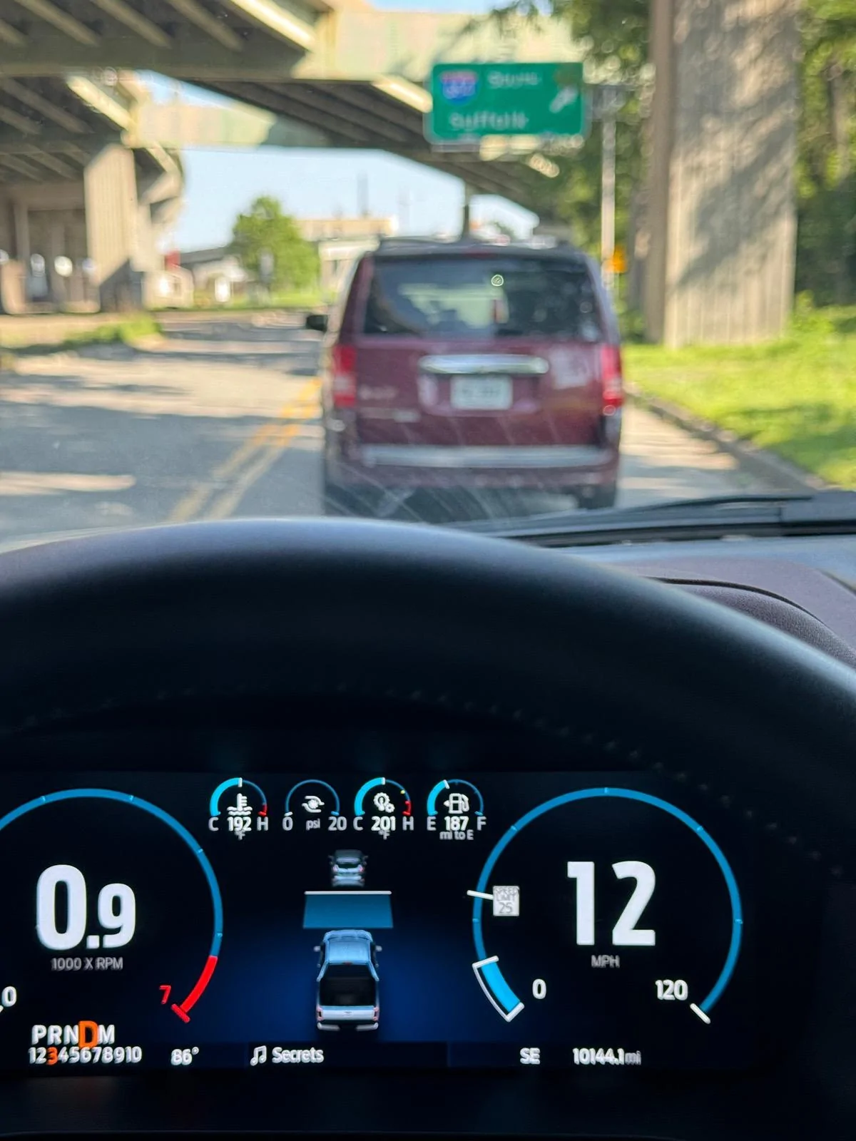

I was driving underneath a highway in traffic so my ACC was on auto resume at 22MPH. After stopping it decided that it no longer wanted to recognize the van in front of me and resumed while they were stopped. Luckily I was paying attention and stopped it. Then on the way home I turned on ACC again but it would not register the car in front me. It was working fine this morning. No errors or anything.
Ford F-150 ACC Radar failing? IMG_4193
Ford F-150 ACC Radar failing? IMG_4195

Your first picture shows it canceled. Did you accidentally hit the brake or steering wheel button? You only need to brush the brake pedal for it to cancel, at least on mine the pedal switch if very sensitive. I would go for a test drive and check it out again.

It’s not cancelled. It’s paused. But if you look at the radar it doesn’t register the car in front of it. In the second photo it’s not even on and it finally saw the car in front of it.

line thru the 22 is cancelled. That's why it's not using the radar.

Bruh. that picture shows it’s not registering the car. If you look at the second picture the radar is working and cruise control is not on. Radar is always working no matter what.

Go get in your truck. Drive behind someone and see how it sees them no matter why. Get closer and it will turn yellow and red on the distance. Without it being on.

the only thing i can think of is disconnecting the battery for like 30 minutes - 1 hour to let the truck reset itself.
