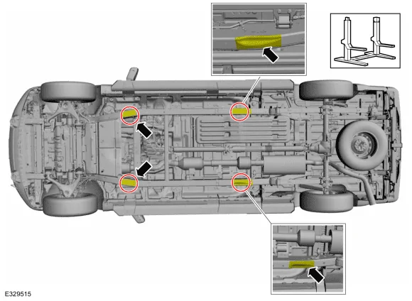

Here's the factory service manual lift points, if it's of any help.
Lifting Points – Front and Rear
HEV
Ford F-150 Quickjack lift point spread 1710879051431-q4
NOTICE: Make sure that no load is placed on the Direct Current/Alternating Current (DC/AC)
Inverter Module.
Ford F-150 Quickjack lift point spread 1710879185478-ds
4WD shown, RWD similar.

Hi Mark, You may have saved me from purchasing two sets of Quickjack! I will measure between these points and I am quite sure it is more than 53 as what I was measuring was the flat part of the frame rail ahead of the shown rear points. Thank you so much!
