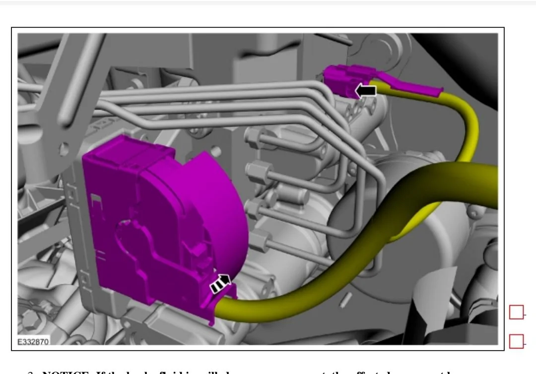

Engine off but brakes engaged requires electric brake booster. It's an Audible device, that's for sure. But necessary technology for this truck.
Open the hood and look on the firewall just in front of the driver. Have someone push the brakes. I'm guessing you will hear the sound coming from the device in the picture below?
