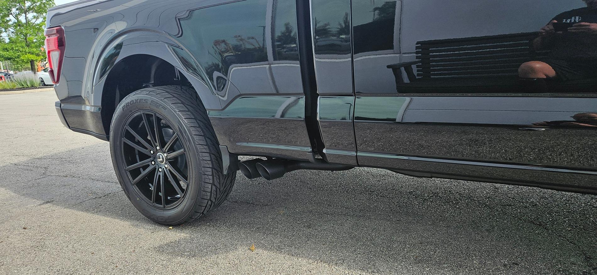

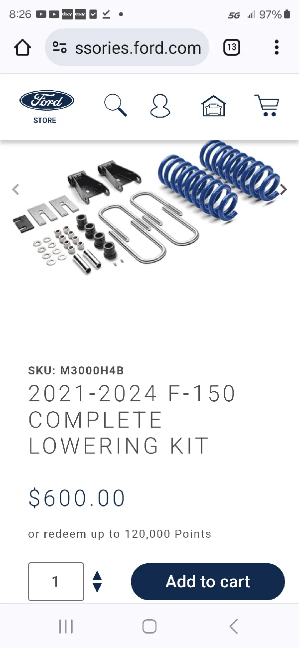

I'm trying to find out which kit I want.
Looking to lower at least 2/4 and maintain good ride quality.
I believe the rear of my truck has the Ford drop shackles and it's definitely not low enough for me.
