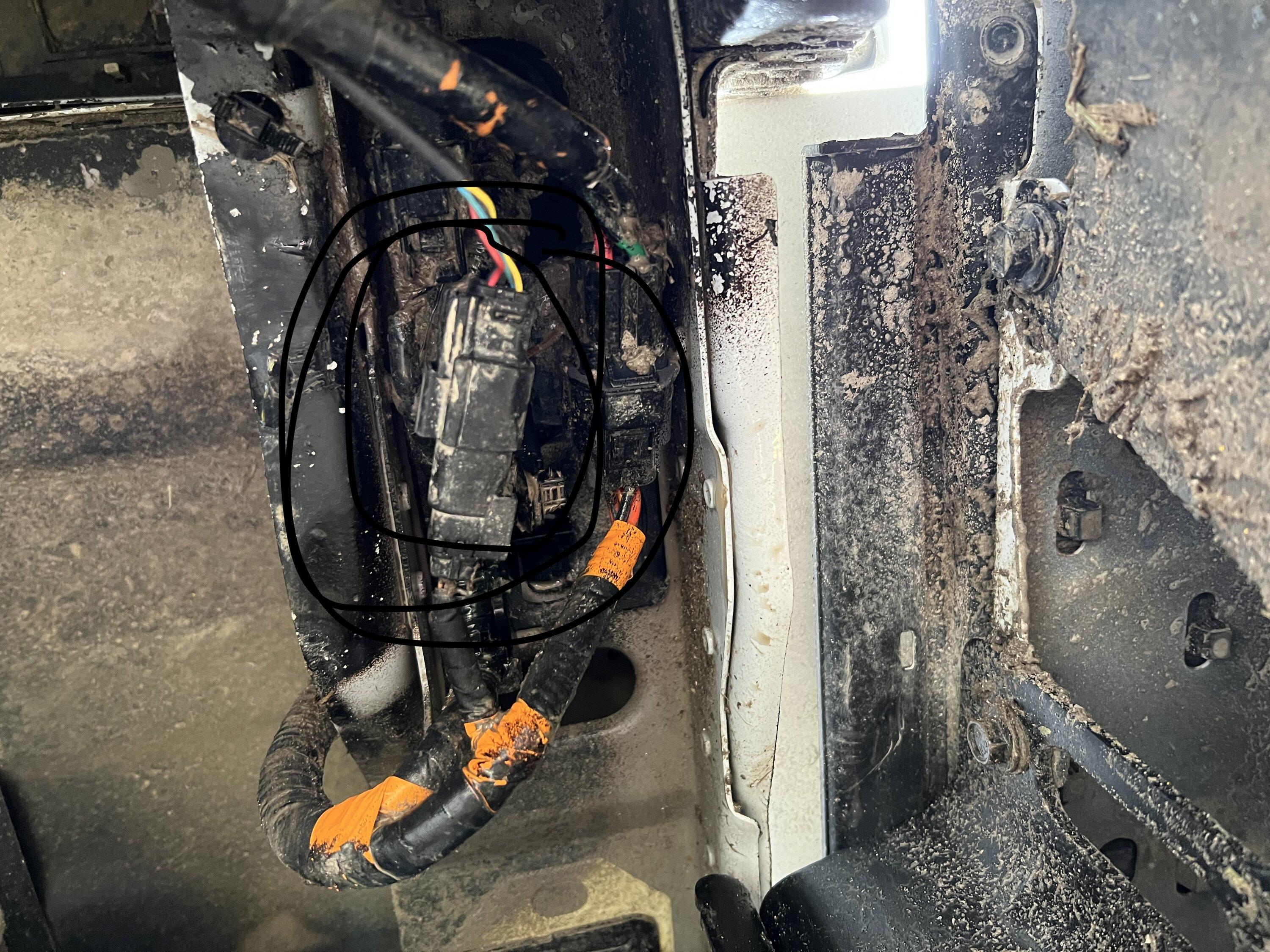

Steve, I put my truck up on ramps a week ago to take care of my differential rust, and to me the prime suspect would be the connector cluster that is directly beneath the electrical panel in the bed. I didn't think to take a picture but there's a big ugly cluster of exposed connectors that are open to the elements. AND...open to picking up spray from the driver's side rear tire.
It's almost too obvious that this is the *likely* root cause of your problem.
If I were in your shoes I would do the following:
  • open all of those connectors, apply contact cleaner, and re-connect.
  • wrap something around the connector cluster, even if it's saran wrap. Find a way to waterproof the connector cluster.
  • put mudflaps/splash guards on your rear wheels. Also wheel well liners would work.
Or do nothing since it's working for you.
When I get under there again I'll take a picture and you'll see what I mean.
hope this helps....
AS NOTED ABOVE.... I have been having issues with my propower tripping the GCFI as well. I get ZERO power and reset would not fix.
So I cleaned all the connectors in the rear that were CAKED with mud. there is a smaller connector there that supposedly senses the lines... My truck for about 2 weeks has been without propower and I double checked this morning. THEN I washed the connectors in the read of all the mud, and unplugged the smalled of them with the 4 positions. Dirty water came out of the connector so I blew it out and re-plugged. NOW POWER WORKS. If you unplug that connector and restart the truck pro power stops. So something in there I think is causing issues..
Dielectric grease and or some shrink tubing may help?? something to monitor

I had this issue occur this week... Drove through rain a few days ago and it continually popped up, never successfully resetting, and it occured again today driving through slush (probably salty slush), although it cleared after a few miles.
I've driven through rain before without issue.
I wonder if it has something to do with the salt they use to treat the roads for ice... That would increase conductivity.
I think you're on to something here. Ever since we had a storm and below freezing and salt applied my truck was throwing the Ground Fault at or shortly after startup. Sometimes it would reset sometimes it wouldn't. Would always come back during driving. Now that temps went above freezing and they haven't salted the roads, I gave the truck a good under wash and no issues for last few days. I will cancel my Dealer appointment as they won't be able to duplicate I'm sure. Will see if this comes back after the next snow when they salt the roads again.
I cut a length of pool noodle type pipe insulation and wrapped that main ProPower connector just behind the rear wheel well. Although it looked like a pretty good sealed connector, man is it in a hostile environment!
I disconnected it, applied some dielectric grease, and then encapsulated the whole thing in the insulation.
Fortunately it's really easy to access and address. :)
