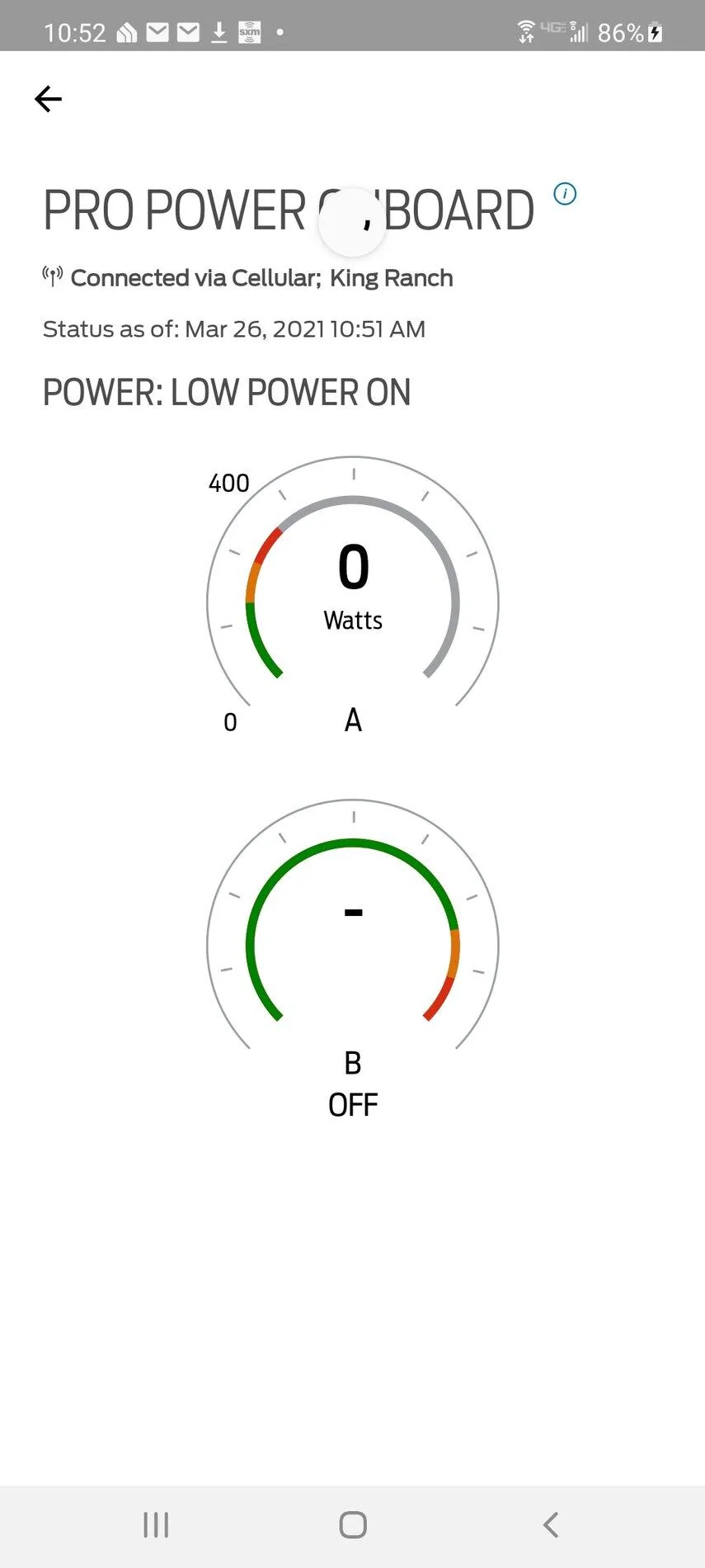

My Phase A is always on when I start my KR. It appears to go from Red to Yellow at some point, but I have not seen it go to green. Interesting enough when you look on the Ford Pass App and go into the Pro Power section it shows green, yellow and red zones?
Ford F-150 Pro Power comes on automatically at startup? Screenshot_20210326-105200_FordPass

This thread might be mixing 2 things:
If you have a phase A and B, you have a 7.2kW powerboost. The interior outlets ALL run on phase A. The regular 400W inverter under the 40% rear seat handles this, it's the same inverter we've had for years on these trucks, inverting from the 12V battery. So propower isn't so much "on" as it is "available". (at least, that is my interpretation of the behavior I've seen and what I've read)
If you have a 2kW propower then you do not have a hybrid you have an EB or 5.0. You have a giant inverter under the 60% rear seat in addition to the same old 400W inverter under the 40% rear seat. I don't have experience playing with one of these but I have seen complaints that it starts as "on" and is very loud, and you have to turn it off. Seems like it should default to off and is an oversight by Ford.
