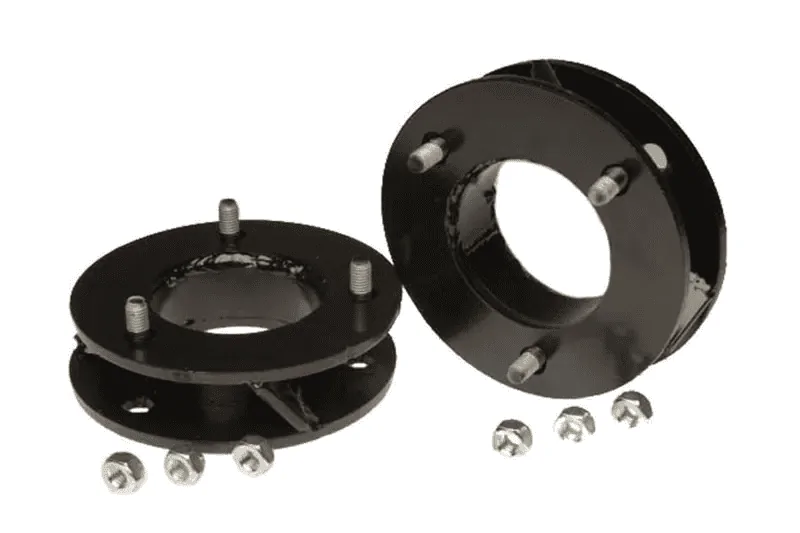

There is actually some truth to this...
The AS kit is just a spacer that sits on top of the strut (aka coilover). The spacer lifts the truck, but also creates a longer overall length from the top of the spacer to the bottom of the strut. This extra length allows the potential for wheel to droop further than intended in certain situations (steeper CV angles).

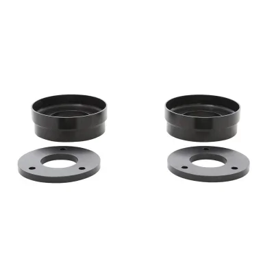

The ProComp 2-1/2" kit uses both a small spacer above the strut/coilover, and a spacer that installs above the spring itself. The spring spacer is installed by disassembling the strut and compressing the spring. Compressing the spring creates a stiffer spring that lifts the truck, but the strut still maintains its total length at full droop. When combining this with the smaller spacer above the strut, you gain the 2-1/2" lift, but it doesn’t allow for the more severe CV angles at full droop that are seen when just using the 2-1/2 upper spacer like the one from AS.
I like the idea of the ProComp setup, but I personally went with the 1-1/2" AS kit in an effort to maintain the factory ride quality, but give it just a little lift while keeping some rake for towing.
Auto Spring:

ProComp:

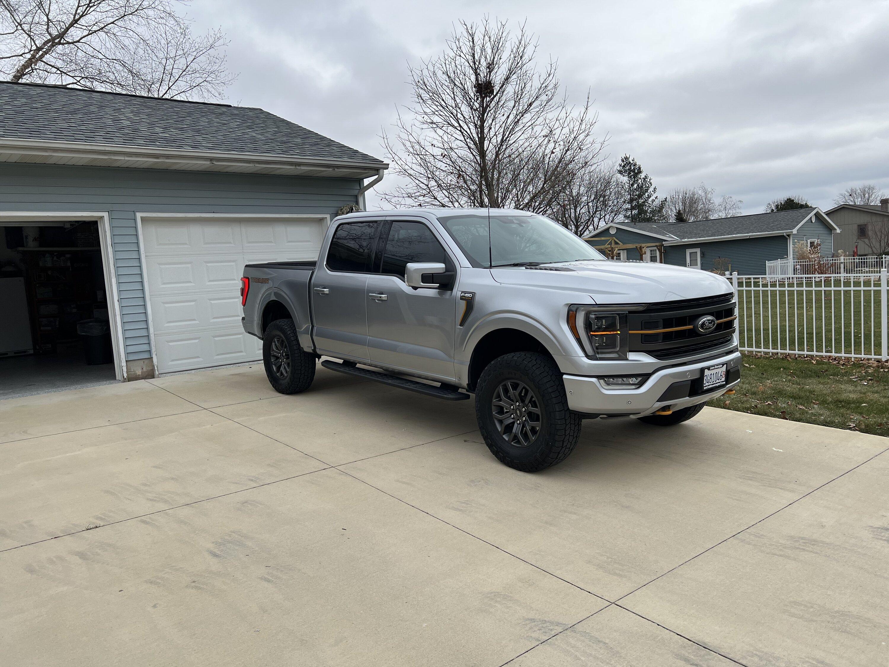

I appreciate the reply. I ended up installing the 2.5 AS kit. Looks great. I haven’t had time to measure the difference that I gained but it appears to still have a little rake which I was shooting for. Ride quality seems unchanged. I think I will have my dealer check the cameras and sensors this weekend to make sure it’s all calibrated for the new ride height. Thanks again though. Hopefully I won’t have any issues with the AS kit. ?
