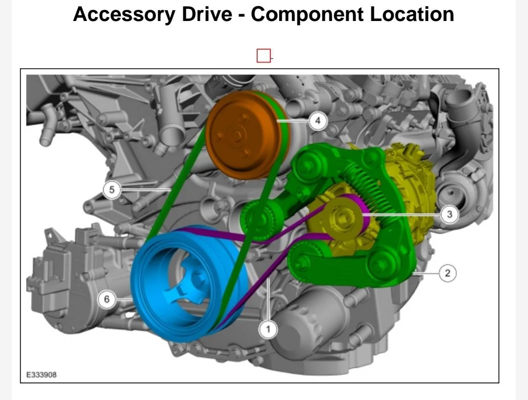

There IS a belt drive starter (yellow) on the Powerboost. It has a pretty hefty belt tensioning mechanism (green) for keeping the belt from slipping though.

However, the term "squeel" has been used for the same circumstances you describe and there turned out to be more than one source.
Transmission fluid level.
Turbo wastegate actuators.
Exhaust Heat Exchanger valve actuator.
Squeal is a subjective term and not all squeals are the same.
Good luck with your dealership. Hopefully you get a good technician and he/she zeros in on the culprit.
