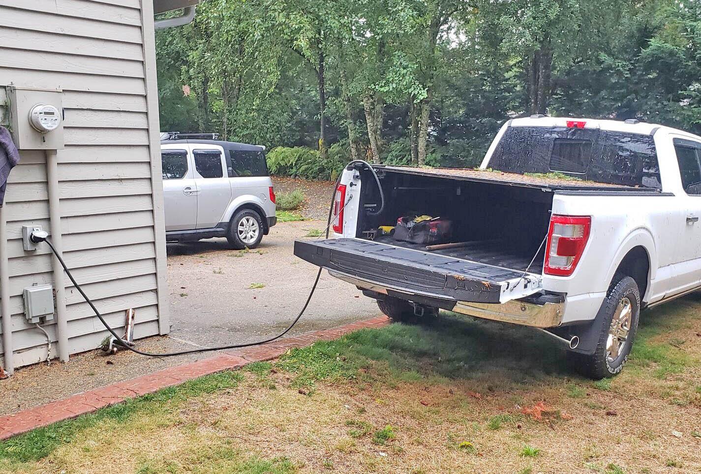

Shout out the 2021 f150 power boost. Had power outage for 2 days and ran the whole house with no problem.
Ford F-150 PowerBoost Pro Power Onboard Generator  VS Power outage! 20210918_084344

Didn’t work for me. Truck thought it had a ground fault and shut off. Another forum said I needed a three pole transfer switch but my electrician couldn’t find one. My house is about 15 years old.
You can remove the ground connection in your generator cable and it will work.

If I don't have a transfer switch yet what can I do in the event we lose power at some point?
Without a safe transfer switch I believe you're best off running extension cords in to the house. There may be other ways I'm unaware of though.

You can remove the neutral/ground bond in your box.
Thats a horrible idea and against National Electrical Code for separately derived electrical systems, which this truck is. By the right equipment to do the job right

I tried making this argument on the f150forum but it wasn't going super well it seemed, a lot of it falling down to it being easier to just use the main panel. Definitely never any consequences for taking the easy way though.
I completely understand.
Mine was temporary for three days.
Being a separately derived electrical system, the truck has the neutral/ ground bonded.
The right equipment to do the right job doesn't exist currently. The right equipment would give me more than 6 to 10 circuits.
And, it is better than not connecting the ground wire on the cord from the truck to the house.
