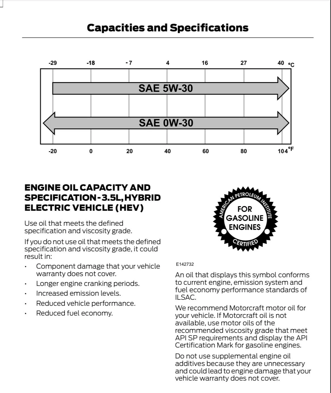

Hello all.. new to the forum, not to trucks. Getting ready to put in a few case order for oil and filters to lay in a supply for the new 2021 F150 PB 3.5 we have on order.. does it still use the 5w-30? Same filter as 3.5 EB 2020?

5w-30 according to the manual. filter FL-500-S

Make sure the oil is GF-6 rated. Most are GF-5. Just a heads up in case you don’t run motorcraft oil.

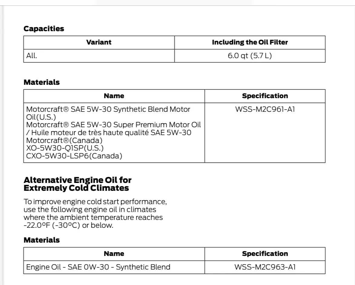

Any oil that meets the Ford WSS-M2C961-A1 spec, as shown above. I'm going to change out my oil after 500-1000 mi using Castrol Edge 5w-30 (which meets that spec) and the OEM filter. The Castrol oil is full synthetic, and I believe the oil from the factory is partial synthetic (of course, to save cost on a $70k truck).
