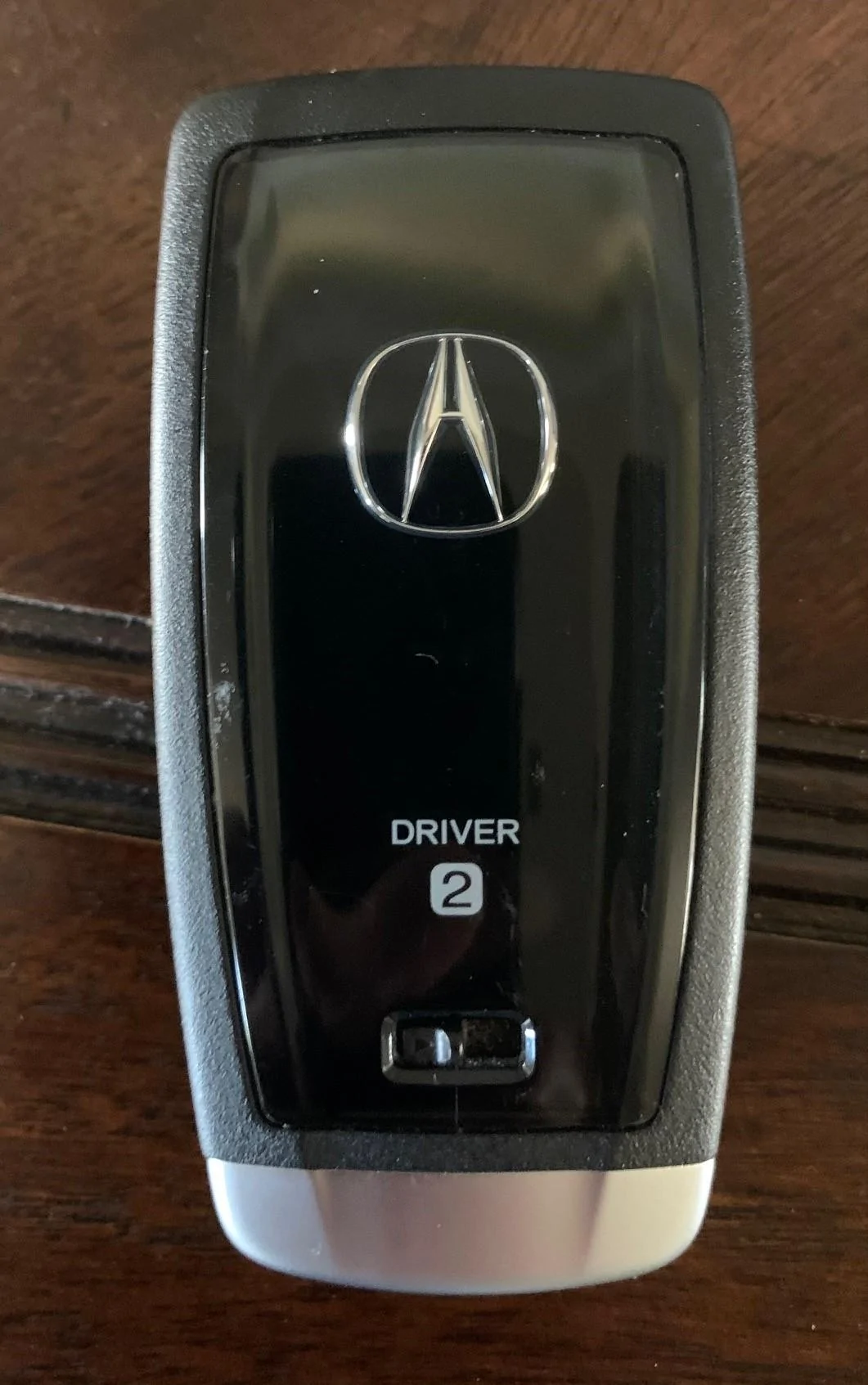

I liken it to what happens when I get in my wife’s Acura using her key:
At first it tries to kill me by squishing me into my wifes seat position of choice.
Next I press the driver 2 button (seat controls) and it sets everything to what is comfortable for me.
By pressing the driver 2 button or otherwise changing the settings while using my wifes key, I am not changing her preferences (just temporarily overriding for that trip). The next time I get in using my wifes key it will again try to recreate the trash compactor scene from star wars.
So it sounds to me that super complicated paragraph is basically simply stating the same thing: If you adjust things while in a driver profile you are not changing that profile and if you are using a key that has no profile the last used profile remains in effect.
