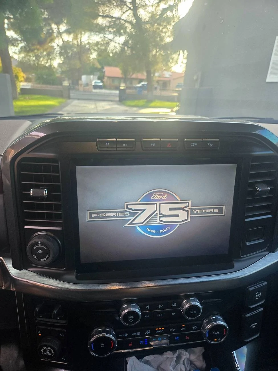

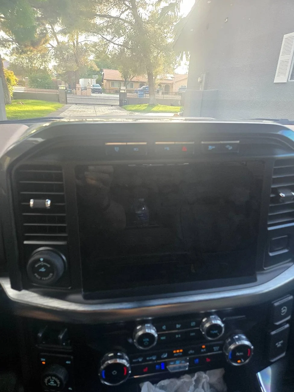

Took my 23 Lariat Powerboost to dealership for battery issue and a couple of recalls. Of course they both engine bay battery and auxiliary battery. Engine bay battery tested fine but auxiliary battery tested bad so they replaced auxiliary battery. They also did recall for e-brake cable possible rubbing on rear axle. and reprogrammed PCM. Got my truck back so on my way home noticed clock was displaying wrong time. When I got home I went to the clock screen to adjust time and thr screen froze. I wasn't able to clear or reset. All of a sudden the screen went black and no audio. I tried resetting IPMA but no luck. So, I took my truck back the next day and dealership wouldn't look at it. Just said I need to make an appointment which was a week later. Now I'm driving my truck with a black Saturn and no audio for a week. Not a happy camper but I'll deal with dealership later. My question is would there be any issues with reprogramming the PCM that would affect my Sync screen?

Tried disconnecting both negatives on both batteries for 30 minutes but no changes. Still black screen

I checked for DTC's. None found so I reset APIM again and that corrected the screen issues.
