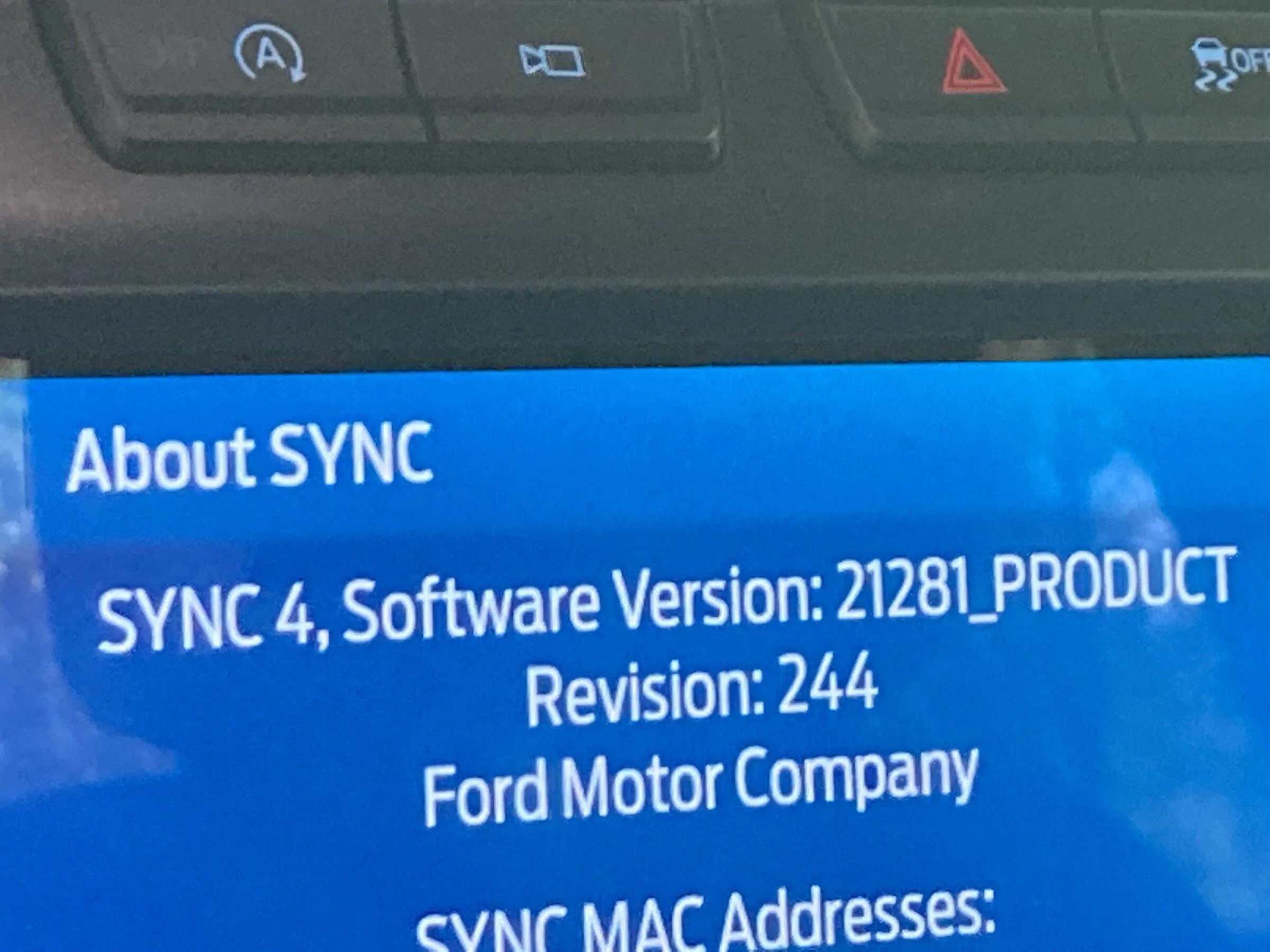

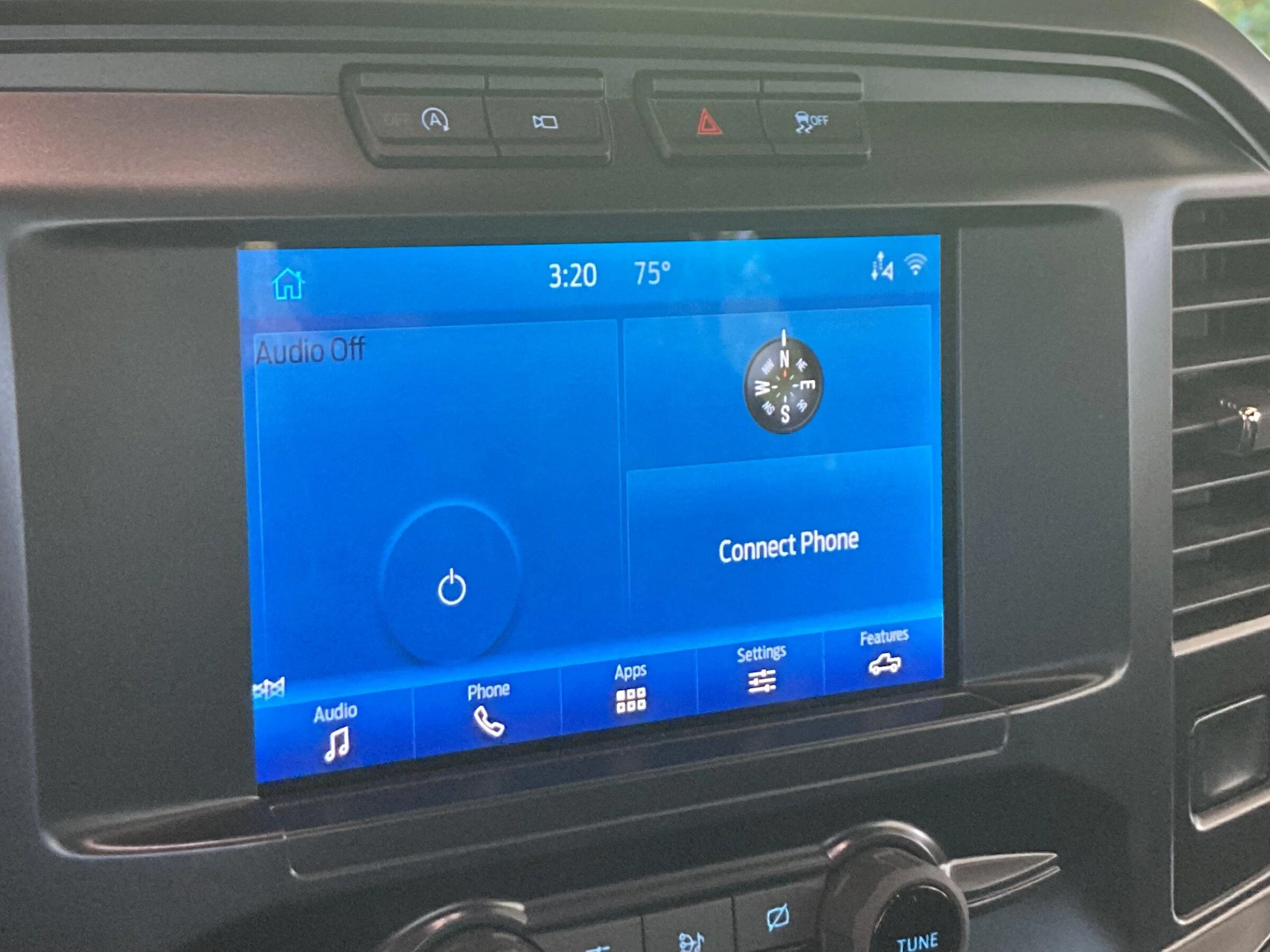

F-150
I believe I got a back update from Ford while connected to wifi. The system shows that there is no update available, but the interface is horribly misconfigured. Unable to use even the manual on the unit. No nav, no carplay usability. I checked on the Ford site with my VIN and it shows there is nothing for me to manually download and update via USB.
I've done the typical "resets" (steering wheel buttons, head unit buttons, master reset, removed battery cables for an extended time)
If anyone has the appropriate file for me to try (if it isn't VIN specific) or knows how to further troubleshoot, it would be greatly appreciated.
Cheers!

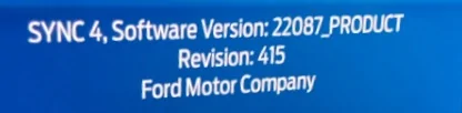

Same shit, another update. Thanks @Ford Motor Company Called OTA support multiple times, there is literally nothing they can push to the vehicle. Unfortunately there is only a series of soft resets they can offer. I genuinely have no idea how not being able to update via USB passed QA.
Here's my latest unusable interface
Software Version: 22087_PRODUCT Revision: 415
Check for updates shows that I have the latest available to my vehicle
Last time I called the dealer and said that I need them to manually update my vehicle the service advisor said it would take 5 days and not only is that impossible for me to be without a vehicle that long, it's also something that could have been completely avoidable should we have the ability to update at home.
I can send you files if you send me your vin

@Jesse-Infotainment got me straightened out with a USB update. Everything is back to working as it should.
Let's hope I don't have to revive this thread in a couple of months, but if I do I know exactly who to talk to. ?
