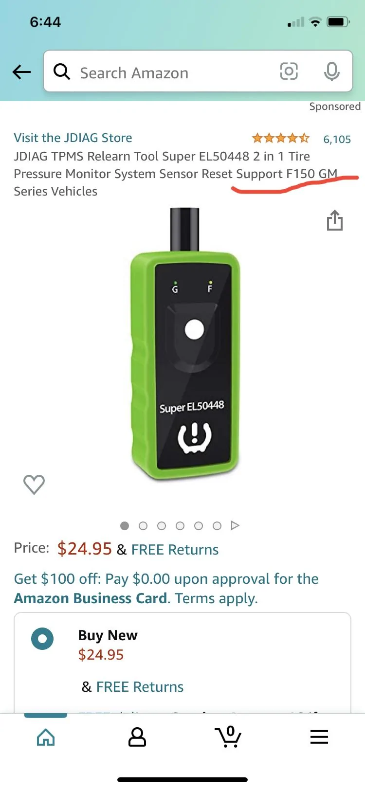

I bought the ford tpms trainer remote on Amazon for my mustang. It was like $17

2nd on the purchase link?

What I posted, I’m not sure if it works I was just trying to see if it is the same as what was mentioned above
