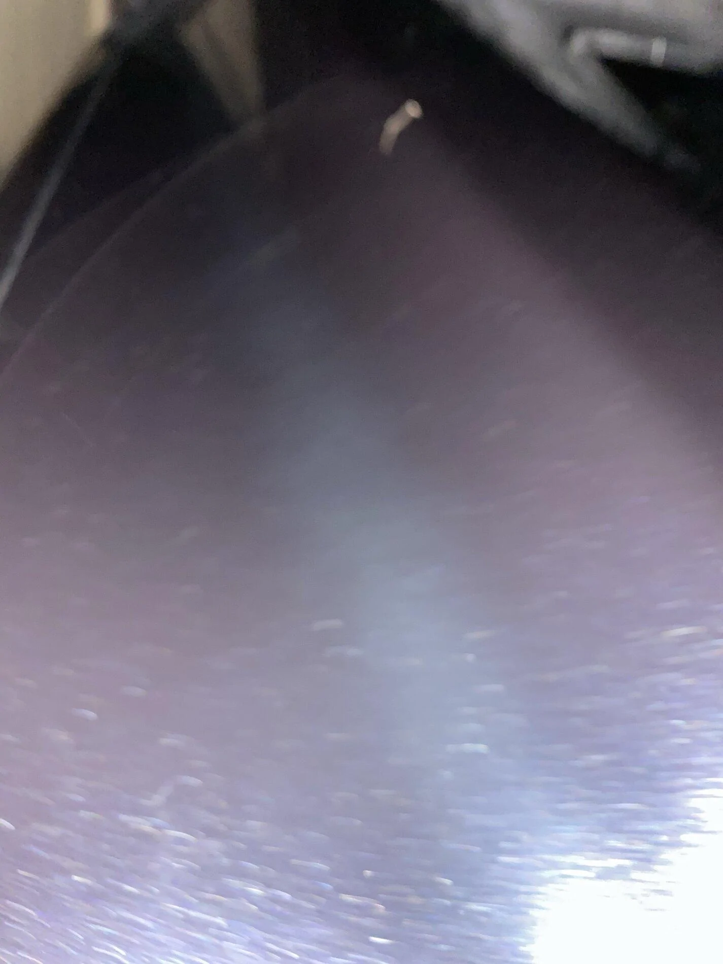

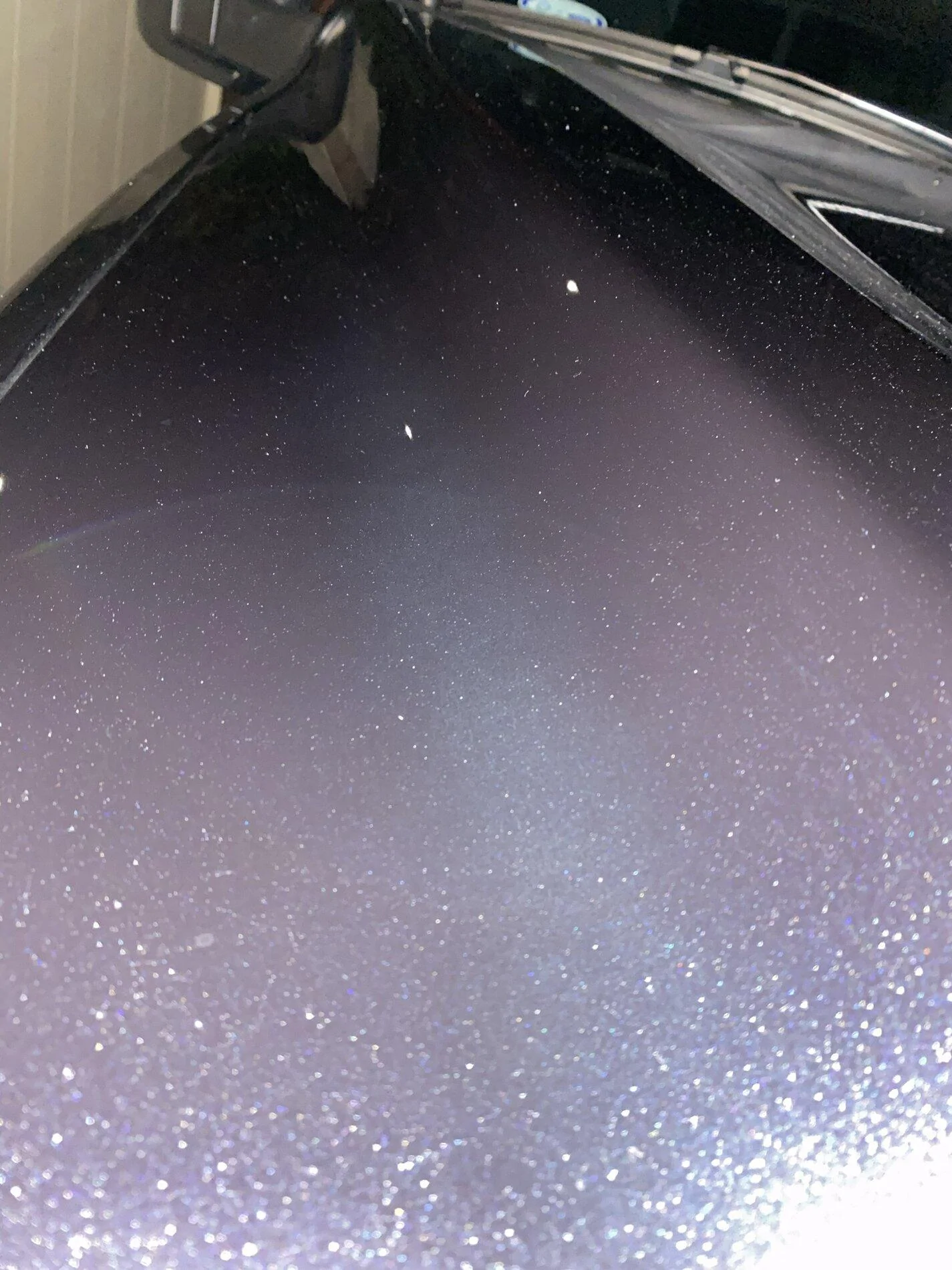

I’m still waiting on some parts (3wks) so my dealer can finish the concerns I had on delivery. As I have had the truck, Ive noticed more and more paint issues. Most are on the list for the dealer to try and address. I just am at the point that I feel like I’m being too picky. Several problems were some sort contamination causing a bump in the paint. Super small and hardly noticeable, but it’s there... How picky would you guys be? I go from being pissed to just wanting to forget it and live with the issues. I do love the truck, but these fit and finish

Listen, it’s your truck. If you aren’t happy, your dealer shouldn’t be happy. It’s a big purchase. Get it fixed!!

Some of those may be able to be corrected by a good body shop. But I don’t think you’re being too picky. Those are defects that aren’t acceptable. I am very particular about paintwork and mine looks pretty good. No defects like those.

It’s also hard because I don’t know how much correction that I want to get into with the factory paint. Ultimately I just want the truck looking good but this is ridiculous. There’s probably at least a dozen of those little bumps that you can see in various spots on the truck, and then there’s probably a half dozen of the little dimples. There are runs in several spots. I’m not sure if this was a Friday truck, or being from KC, maybe day of after the Super Bowl truck..lol. This is also the rapid read which cost additional money for them to paint it to which kind of adds insult to injury. So far the dealer has been fine and we’ve just been waiting for parts for three weeks but now when I return and my list has doubled with additional items I’m not sure how it’s going to go down. To top off the factory issues, at some point before delivery the tailgate ended up with some very minor scratches at the dealer and somebody tried to buff them out and then burnt through the paint. So I know a section of tailgate will have to be painted and blended. It’s just a pain in the ass when you want your truck ready. Not to mention I ordered this on July 17 of last year and just took delivery on March 25. I’d be safe to say this was one of the longest waits too.

I know exactly how you feel, as I also got a bunch of paint and body defects.
Those parts where there is clearly something that is underneath the paint are really frustrating. You know that the guy who put the clear coat on must've seen’t it and didn’t even think to fix it before proceeding.

My take on this is:
Standard color no extra cost item—the pimples need to be taken care of, but I would not be as concerned so much with what looks like a fisheye unless they were all over the car. This implies something managed to get sprayed onto the surface right before paint, and the paint may lift over time.
Extra cost paint option, should be close to show quality.
Sadly, you are in a catch 22 situation.
You either live with it and have a bad taste in your mouth for some time (depending on how long you keep the car)
Attempt to get it all repaired which may cause other issues down the road.
Touchups and blends will eventually show up and possibly be unsightly.
The clear coating will not be the same or applied the same way the robots do it, may not be the same quality, and for it to be done CORRECTLY, the repair becomes panel coverage.

Don’t have a portion of your tailgate repainted and blended. A *good* shop needs a to repaint the whole panel. Get a shop that is certified to do Porsche, Tesla, etc.
btw, good shops these days do flawless work. The dealer dinged my new Vette a few years ago and repainted the door. I insisted on a shop of my choice. It’s perfect.

Now although I understand the frustration and too be honest, I have not gone over my truck in that much detail. (For me it a two year lease) and I have not had the time or weather to hand wash / wax it.
Now the strange part is that the paint process is almost fully done by robots and in theory all should be the same unless the surface was not clean prior to paint or there was some issue with the paint gun.
That aside, what are the options besides refusing the truck on delivery.
- A body shop tries to sand / buff / fill the imperfection (small area)
- Less noticeable maybe if the paint blend matches perfectly
- Maybe simply a change from a dimple to a Color variance.
- A body shop resolves the issues and resprays the complete panel (Door, Fendor, etc.)
- Less noticeable if the paint matches perfectly
- A good body shop guy will be able to tell that it was "fixed" for some reason
- The paint from a body shop cannot be baked on like the plant.
- A body shop resolves the issues and resprays the complete truck
Not making excuses just laying out the options. As a side note "rework" could effect the value of the truck downstream.

Has anyone come across the paint being sprayed too thin?
I have a leadfoot f150 and when the sun hits it just right I can see sections of tan at certain body lines. When I get close I can actually see that the paint was light in that area. Think the dealer will do anything about it? Overall the paint looks great but these tan spots irritate me
Never seen it on the body but all of my dark colored Fords have had the issue on the door hinges and inner door areas. Haven't noticed on my 2020 Mustang though, but it has got one of the best paint jobs I've seen from Ford in awhile.
I have the issue you’re talking about on my black 2021 F150 XLT. Don’t really know what to do here outside of having it re-sprayed but considering the dealer can’t even handle a buffer without swirling the paint I don’t know what to do just deal with it I guess.
