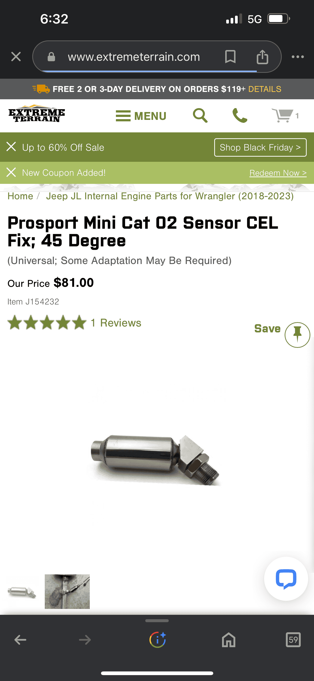

Ive ran these on my k swapped integra, my speed3 and work like a charm. For my 5.0 ima run these, i went with shortys and cat delete with the cut pipes secured with v bands in case i need to swap cats back in on the fly, ca life??
