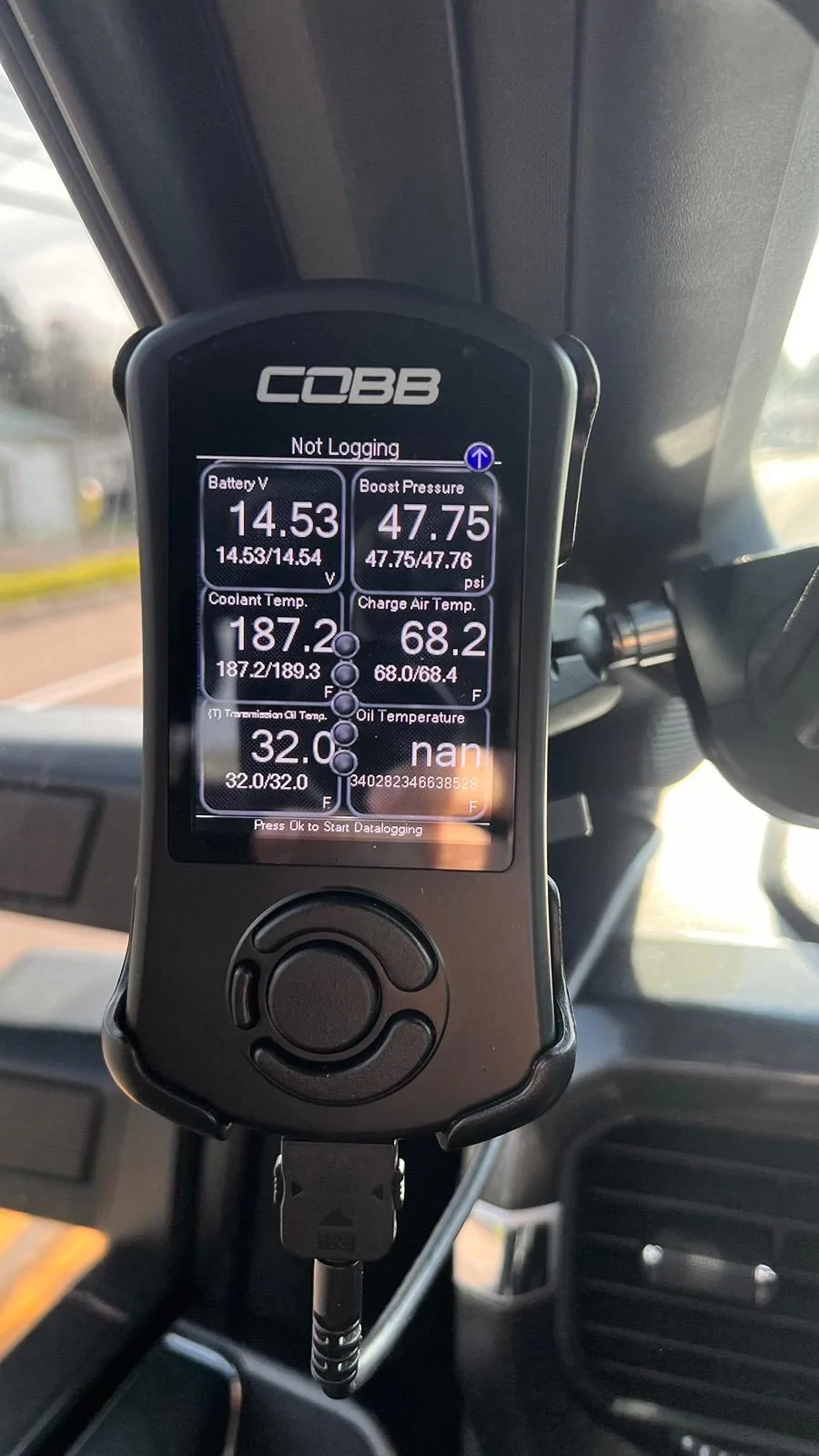

Anybody else notice issues with their Cobb AP since the last OTA update? All of a sudden, my boost is displaying a constant 47lbs (obviously inaccurate), trans temp displaying constant 32 degrees, and oil temp displaying “nan” (not a number). Also, it won’t flash new tunes, says that it’s no longer installed on my vehicle, and lastly noticed my auto start/stop began working for the first time in months. So long that I don’t even remember which method I used to disable it in the first place.

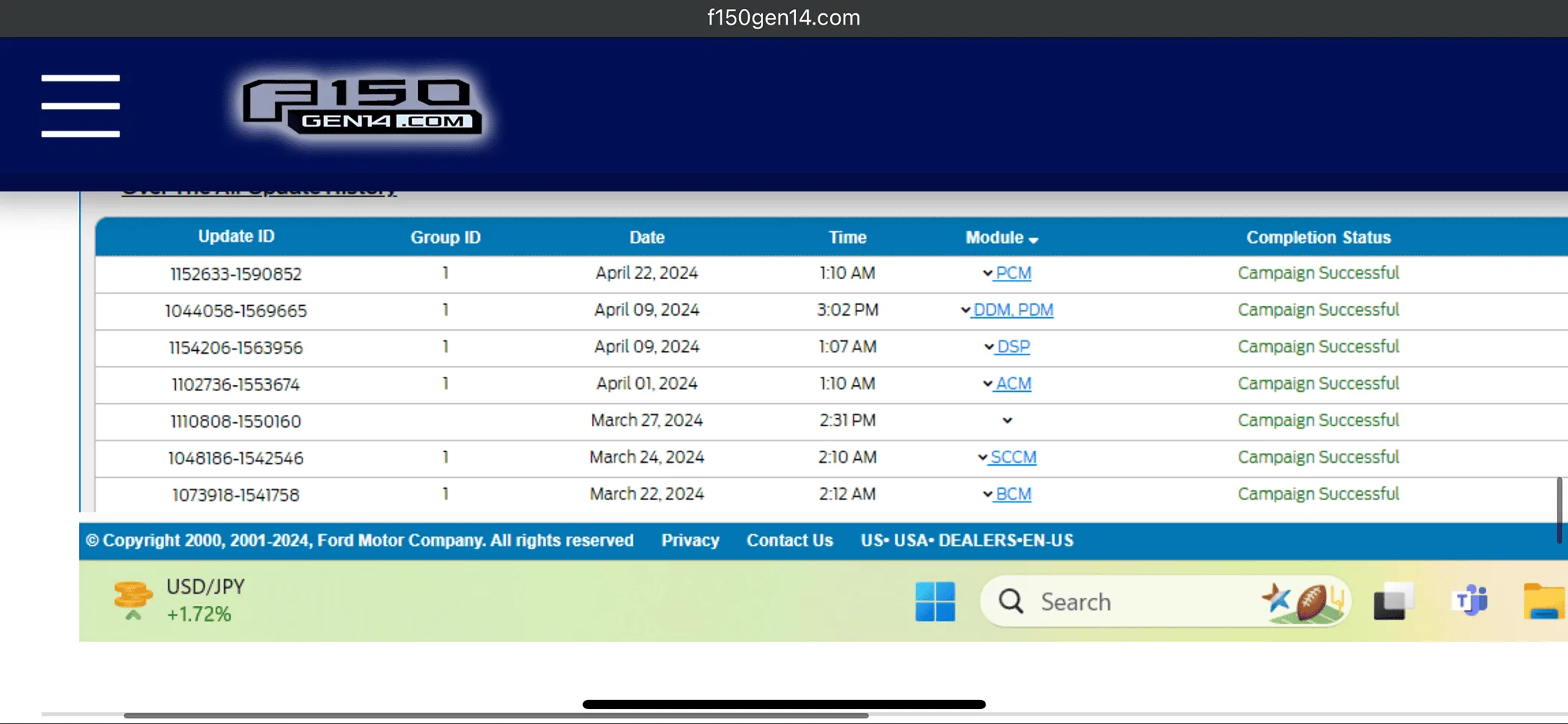

Cobb had to send a new license key for the AP to reinstall it. However now it’s saying my ECU is unsupported. Sending my diagnostic file over to them and will be waiting to hear back.
They requested proof/documentation of the date and time the update was performed so thank you to @rugedraw for the OTA info

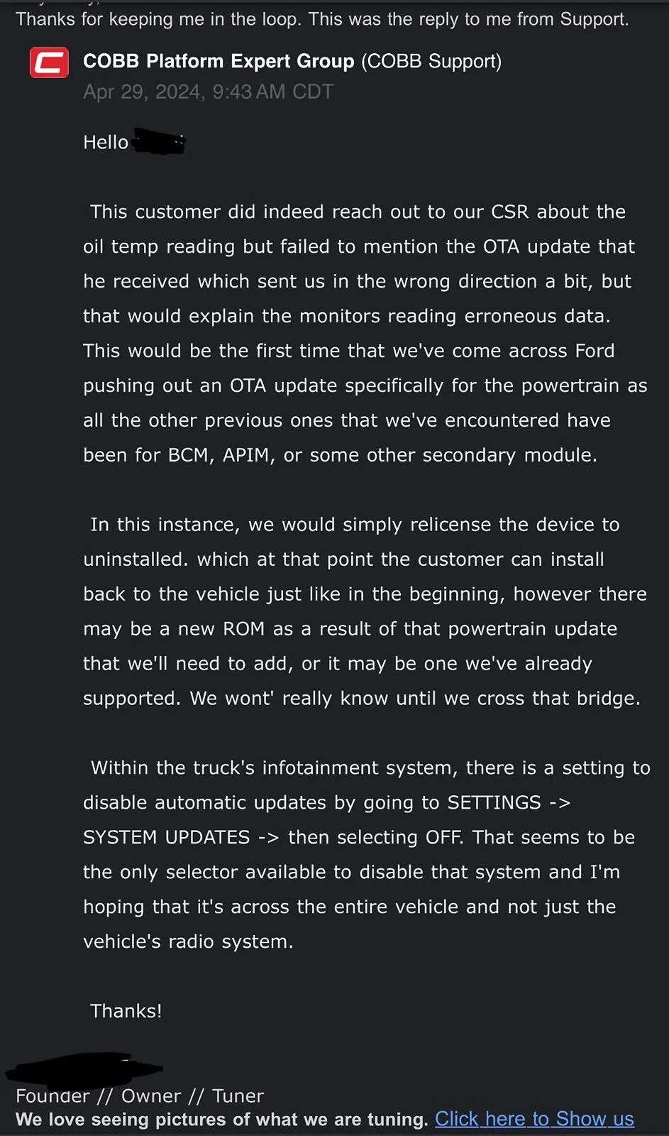

Began the process this morning at 9am CST when Cobb opened. Long story short, they had to write a new beta version of the accessport software for me to download. Had to upload all my custom tunes back to the device, and they are working properly now. This was the official reply from Cobb to my tuner:
