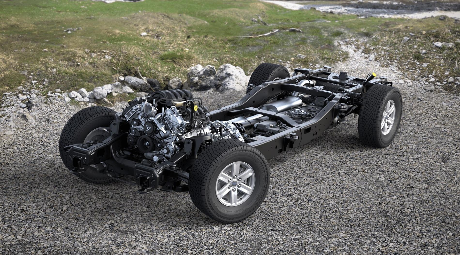

I guess one question is why not four-wheel-drive other than the money. I know it will add a little weight, but is the transfer case a week point in the drivetrain?
Try this:
Place both pictures in the same folder then flip back and forth using a photo app.
Ford F-150 Ordering a 24’ regular cab short bed 2X4 / 4X4 debate. 2x4 F150
Ford F-150 Ordering a 24’ regular cab short bed 2X4 / 4X4 debate. 2x2 F150
