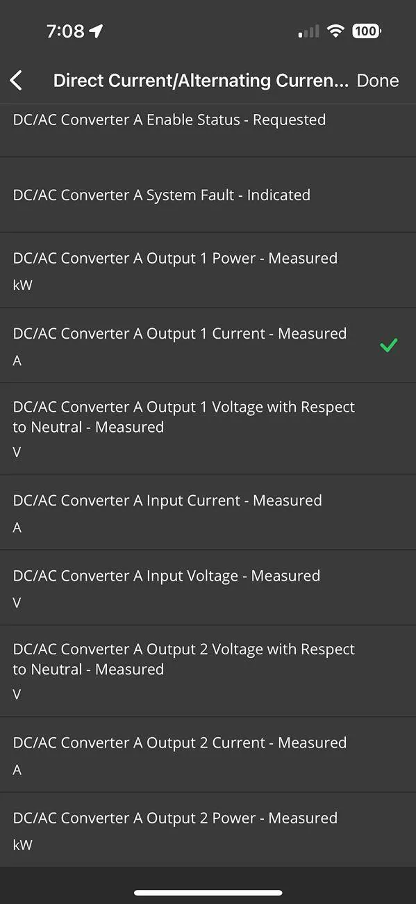

In case no one had stumbled on this thread yet, the new PID release shows the PPOB information.
Link here: https://www.f150gen14.com/forum/threads/powerboost-2-0-we-need-more-than-idiot-lights.30683/
Screenshot attached.
Thanks a lot for sharing this. Unfortunately, my 2021 powerboost does not appear to have the DC/AC Converter. Even after uninstalling the OBDLink app, reinstalling and re-scanning after adding the 2021 OEM package, I don't see the DC to AC Converter PIDS. I'm a little disappointed. My truck says it is up to date with no updates to install. Man, so close!
Ford F-150 OBD PID for Pro Power Generator Output Screenshot_20250113-110635-230
I have no idea if this would work, but could you try to add your truck as a 2023?
I gave it a shot this weekend but no luck. I had some home b/c my truck got an update last week but unfortunately nothing I did was able to get the PPOB PIDs. If anyone else has luck with a 21/22 please let me know how you were able to get them.
