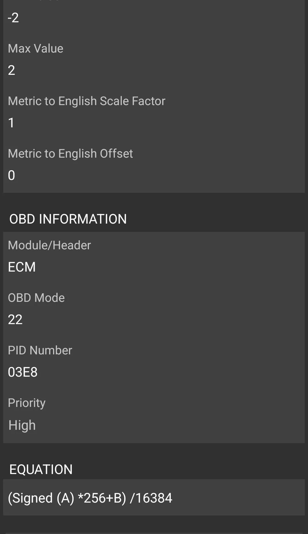

Does anyone happen to have the OBD Fusion PID equations for OAR (Octane adjust ratio) and Knock?

I have this PID working for OAR

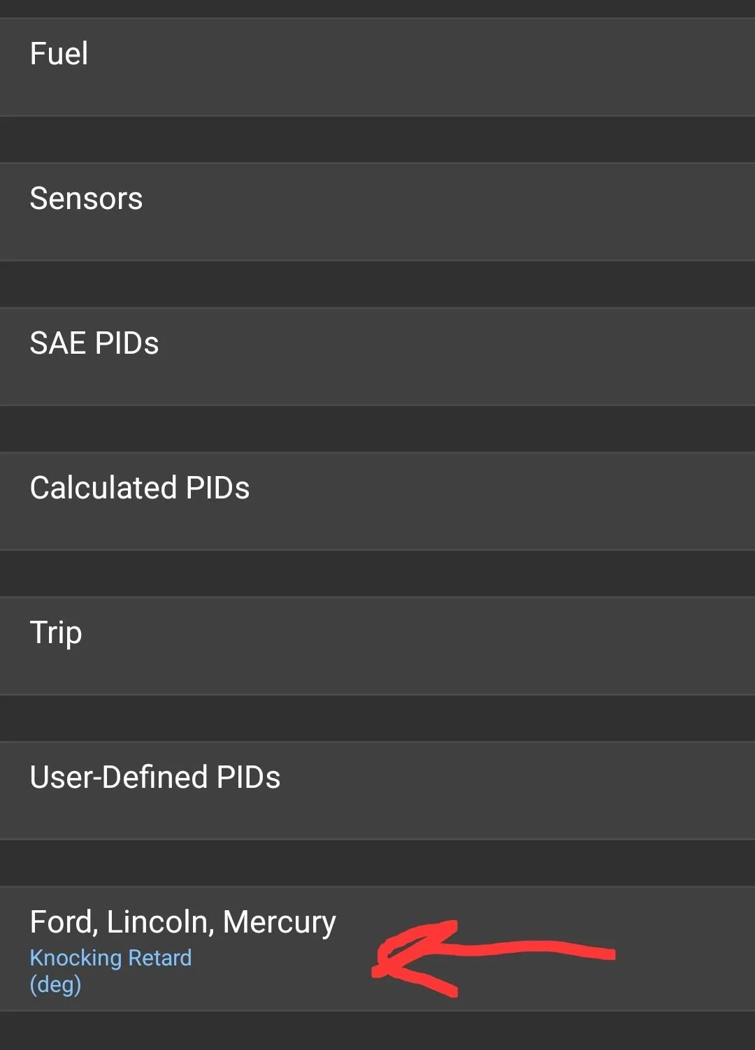

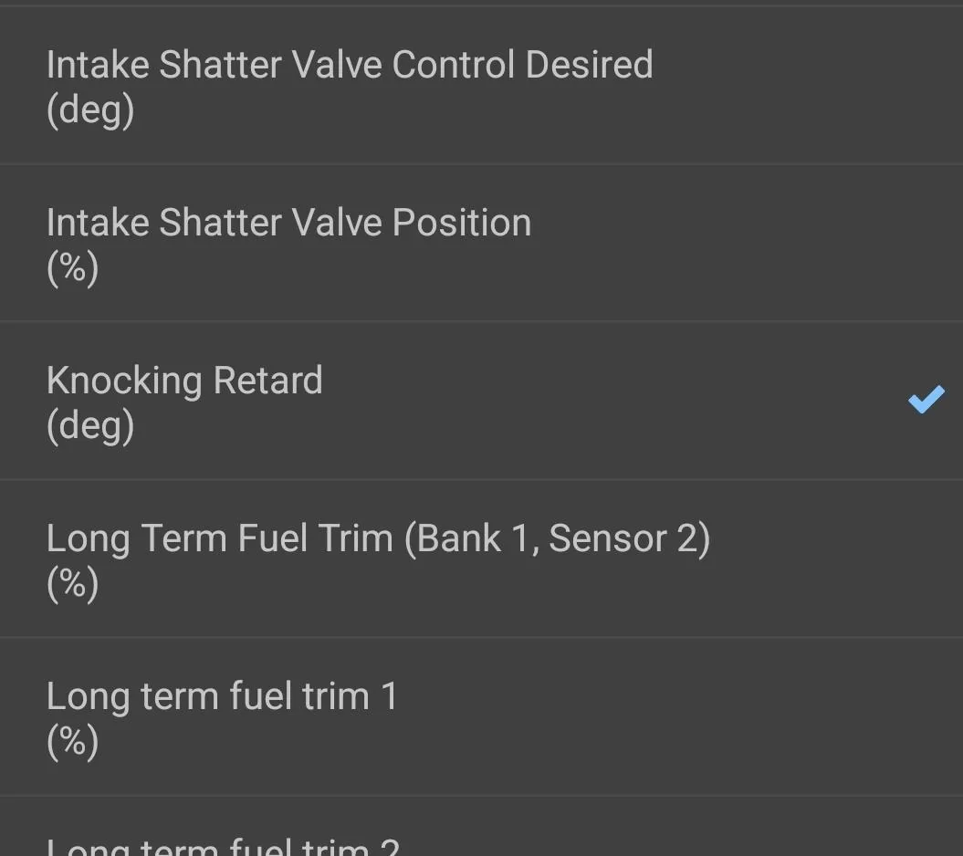

KR should already be available in the Ford pids available
Thanks! Got the OAR working
For the Ford specific PIDs, is that a purchased extra within the OBD fusion app?

I honestly don't think I was charged for it, but maybe you get the first vehicle that you choose free?
I don't remember specifically because I am bad about TRYING them all. At least any of the ones that have a decent following.

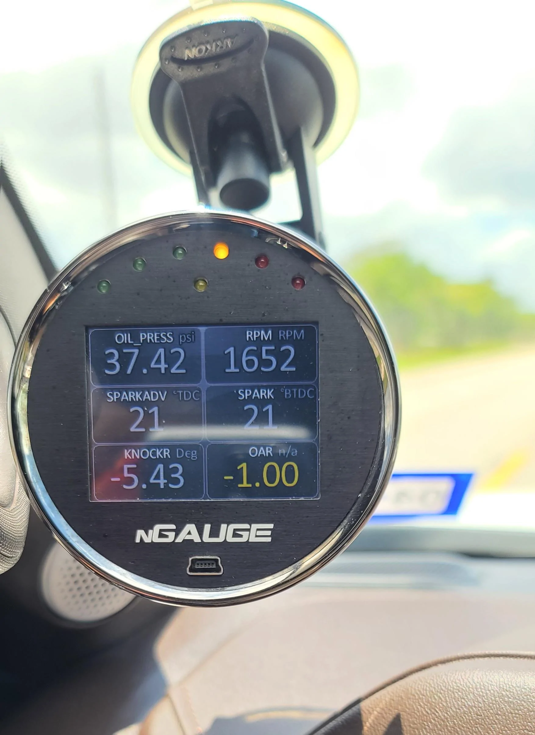

By the way, I'm one pid away from having everything I need for retiring my trusty Ngauge.
I purchased the Ngauge 6 years ago in order to tune my 2018 3.5 Ecoboost F150. It's a fantastic device for monitoring the truck because HPTuners did a great job of including everything you could possibly want to monitor in its firmware. However it was discontinued and nothing like it has ever come along to replace it.
Ford F-150 OBD Fusion PIDs 20220806_132533
Surprisingly it still works perfectly with the Gen14 F150 with the Gen3 3.5 Ecoboost even though HPTuners does not yet support the new pcm.
The one pid that I have not been able to discover anywhere is Oil Pressure. I don't think I am willing to live without it, so I have until the Ngauge dies on me to figure out how the Ngauge reads oil pressure, OR I will need to install an aftermarket oil pressure sensor/gauge kit of some kind.
Interestingly Forscan also has the pid, but I have no intention of using a laptop as a monitoring device. I wish I was smart enough to reverse engineer things like Forscan in order to sniff out those pid parameters. I'm surprised that oil pressure isn't desired enough for the gurus to have cracked it by now. (Like they did for OAR)
