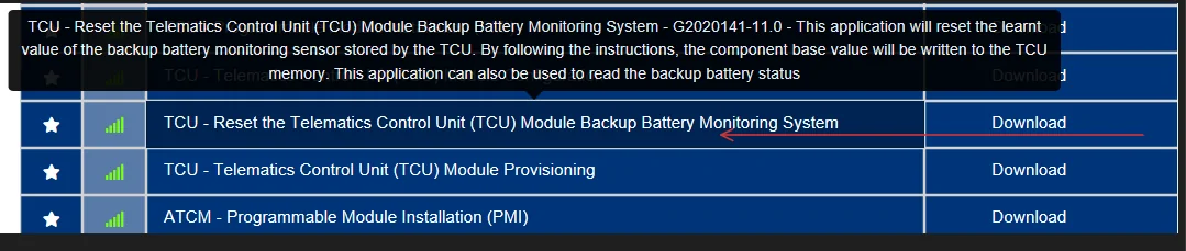

Where is the location of the connector left or right rear seat? Found this in FDRS, is that option viable?
The TCU is behind the rear seat, passenger (right) side. Unfortunately, you have to drop both seat backs to peel back the concealer panel to access it. It’s mounted against the cab wall.
I haven’t used the FDRS options for the TCU as a method of resetting the TCU so I can’t speak to them. When I had a problem with my TCU locking up a couple of months ago, disconnecting the power and letting the capacitors drain is the fix @Jesse-Infotainment recommended and it worked perfectly for me.
As for the APIM option, if it’s the TCU (aka “modem”) that’s causing the problem, resetting the APIM won’t do any good.
