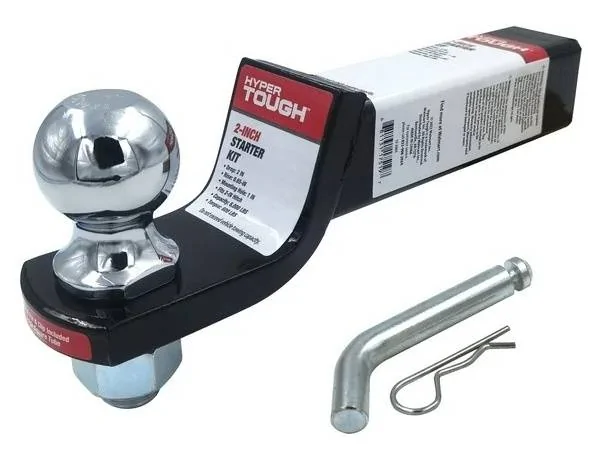

If you're towing a TT over 5k lbs, most likely you'll have a WDH with a 2 5/16" ball. If you're towing anything else, most likely you'll have a regular 2" ball. You want the right tool for the right job. We've been through two different WDH styles, one with bars (Recurve) and one with chains (Andersen). They both came with the 2 5/16" ball. We also have a regular 6k lb 2" ball for utility (https://www.walmart.com/ip/Hyper-To...8-inch-Pin-Class-III-Black-2-inch-Ball/876876), for anything else that pops up. If we needed something specific or adjustable for somethings larger and on a regular basis, would maybe consider something beefier and adjustable. But if that was the case, we'd probably be in a super duty.

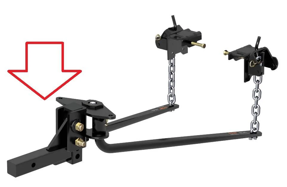

The stinger you point to is rated at 5000lbs max, is it because the weight distribution system would effectively reduce the perceived weight?
A dead-weight stinger
Ford F-150 Newbie: Ball hitch questions DEAD WEIGHT STINGER
Has nothing to do with / no relation to a WDH stinger
Ford F-150 Newbie: Ball hitch questions BAR TYPE WDH STINGER
Ford F-150 Newbie: Ball hitch questions ANDERSEN WDH STINGER
Don't confuse / confabulate the two.
Ah thanks, see being a newbie, I thought weight distribution hitches still needed to connect to a ball, I didn't realize they have their own stinger.
WDHs do use a ball, sized to match the trailer coupler, but the stinger is different than a dead-weight version due to the various adjustments required to properly set-up a WDH for a particular rig / load / torsion transfer system (bars, chains, whatever) specific to the WDH assembly.

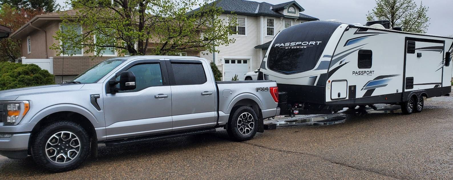

Those type of hitches are okay for light loads, boat, utility trailers etc.
For reference, yesterday our seasonal camping opened up. Unfortunately the weather wasn't cooperating but oh well.
My trailer is 7k after battery and 2x 20# tanks. Add a good 500# of gear and etc... Another good 500# in the box plus the wife and me, say 8k. Wind is 35 gusting 55kph at my 2 or 3 o'clock the whole trip. Very stable trip averaging 90-95kph
