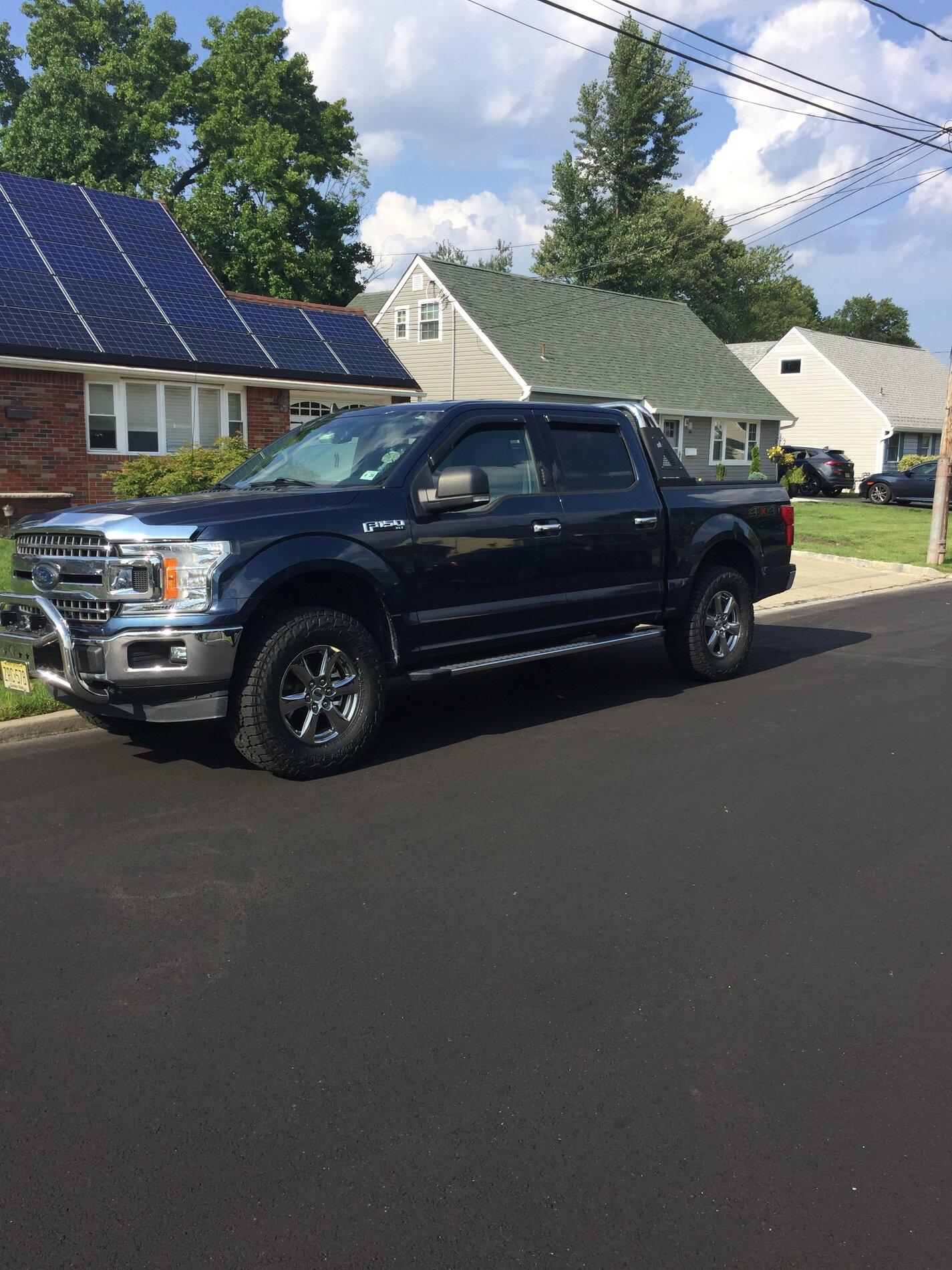

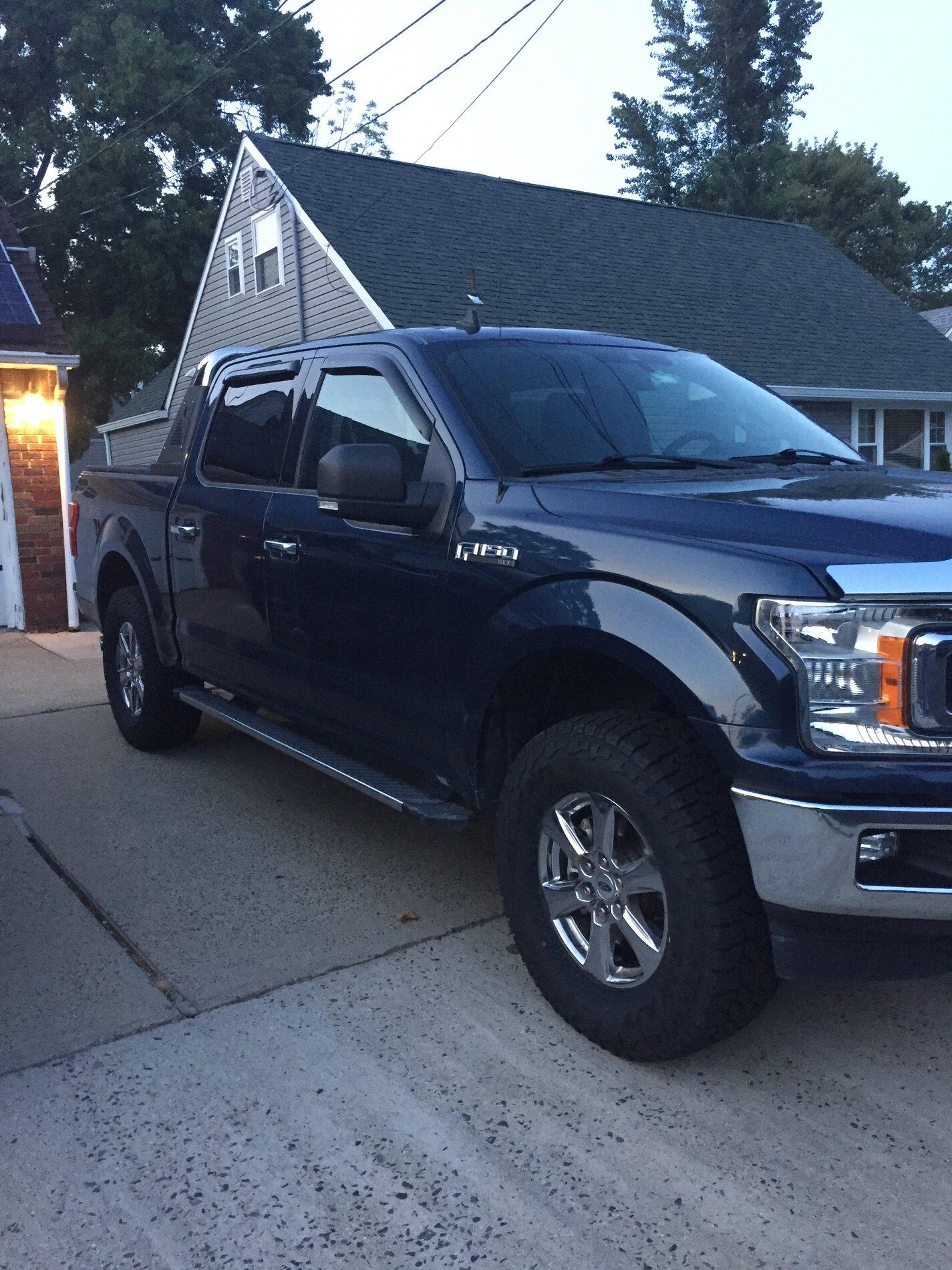

Hello all. I have seen some folks asking if a 295/70/18 would fit on a leveled truck. Just finished mine today. 2019 F150 XLT 4x4 5.0 crew cab.... 3:73 rear.... I installed a set of Rancho Quick lifts on the front.... Bilstein 5100’s on the back.... and Falken Wildpeak 295/70/18’s.... There is no rub.... no trimming needed.... and didn’t have to touch the crash bars.... there’s about 1/2” between the tire and UCA’s... I’m very happy with the look... ride and stance...

Hello all. I have seen some folks asking if a 295/70/18 would fit on a leveled truck. Just finished mine today. 2019 F150 XLT 4x4 5.0 crew cab.... 3:73 rear.... I installed a set of Rancho Quick lifts on the front.... Bilstein 5100’s on the back.... and Falken Wildpeak 295/70/18’s.... There is no rub.... no trimming needed.... and didn’t have to touch the crash bars.... there’s about 1/2” between the tire and UCA’s... I’m very happy with the look... ride and stance... the rims are stock....+44 offset

Did you notice much difference with the bilstein's on just the back? I'm thinking of doing this myself, so curious if you would recommend them.
