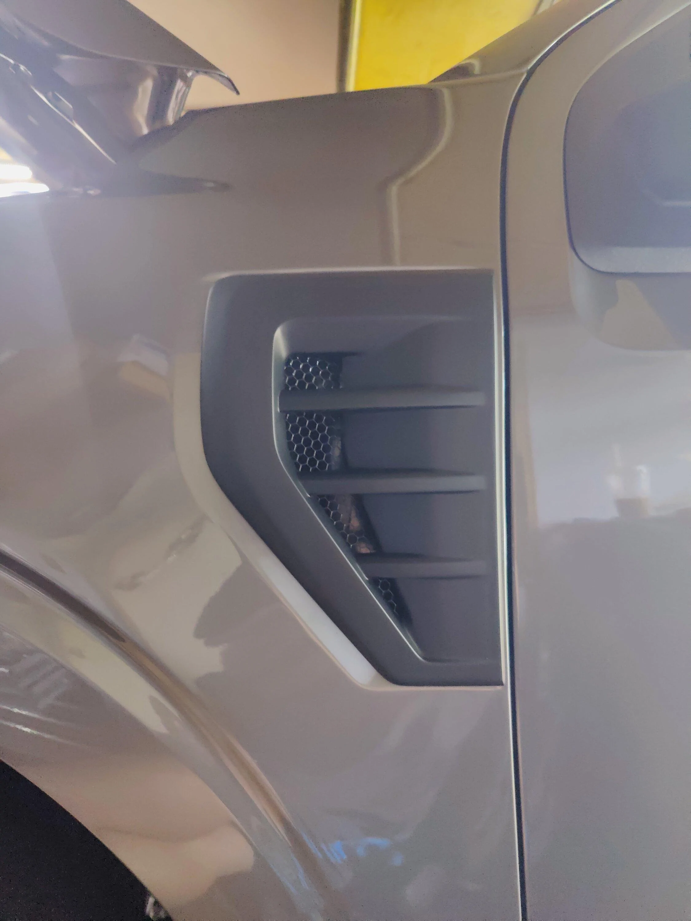

I installed mine 2 weeks ago holding up strong after few car washes. As stated earlier no plastic tabs so as a precaution I've ran few zip ties around metal vent insert and fender mounting holes it was a bit tricky but i got it done from wheel well side I've also heated 3m tape before installing time will tell but very satisfied with the look

What's with the hate for 3m tape? This is the vhb (very high bond) tape, right? Im pretty sure that stuff held on whole trim pieces in previous cars of mine and it never failed (I.e. the side panels of my 2000 grand am). I think the trick is to use adequate pressure when applying it to get the correct bond.
Or maybe this is cheaper non-vhb tabe?
