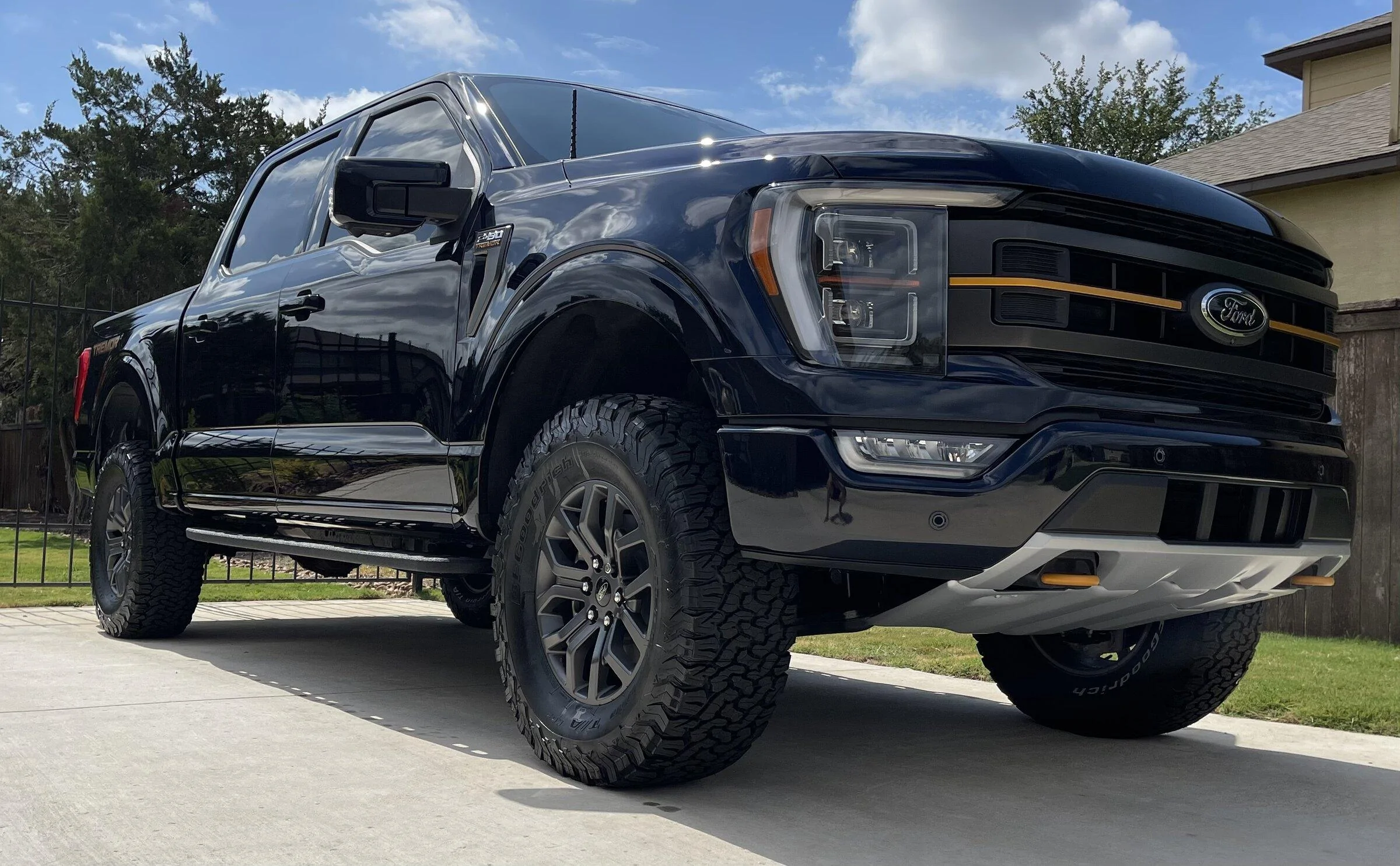

This looks awesome! Cant wait to throw some 35s on mine. How is the clearance with the UCA ball joint with the 12.5s? Ive always run methods on my f150s with 35x12.5s but I want to keep these stock without running spacers or anything so Ive been considering 35x11.5s. Just curious, thanks!
No issues with clearance. They run great. This is the first time I’ve run stock rims. Wheels are flush. I paid for 305s BFGs from discount tire online but they were on back order so they gave me a free upgrade to these ($80 saving per tire)

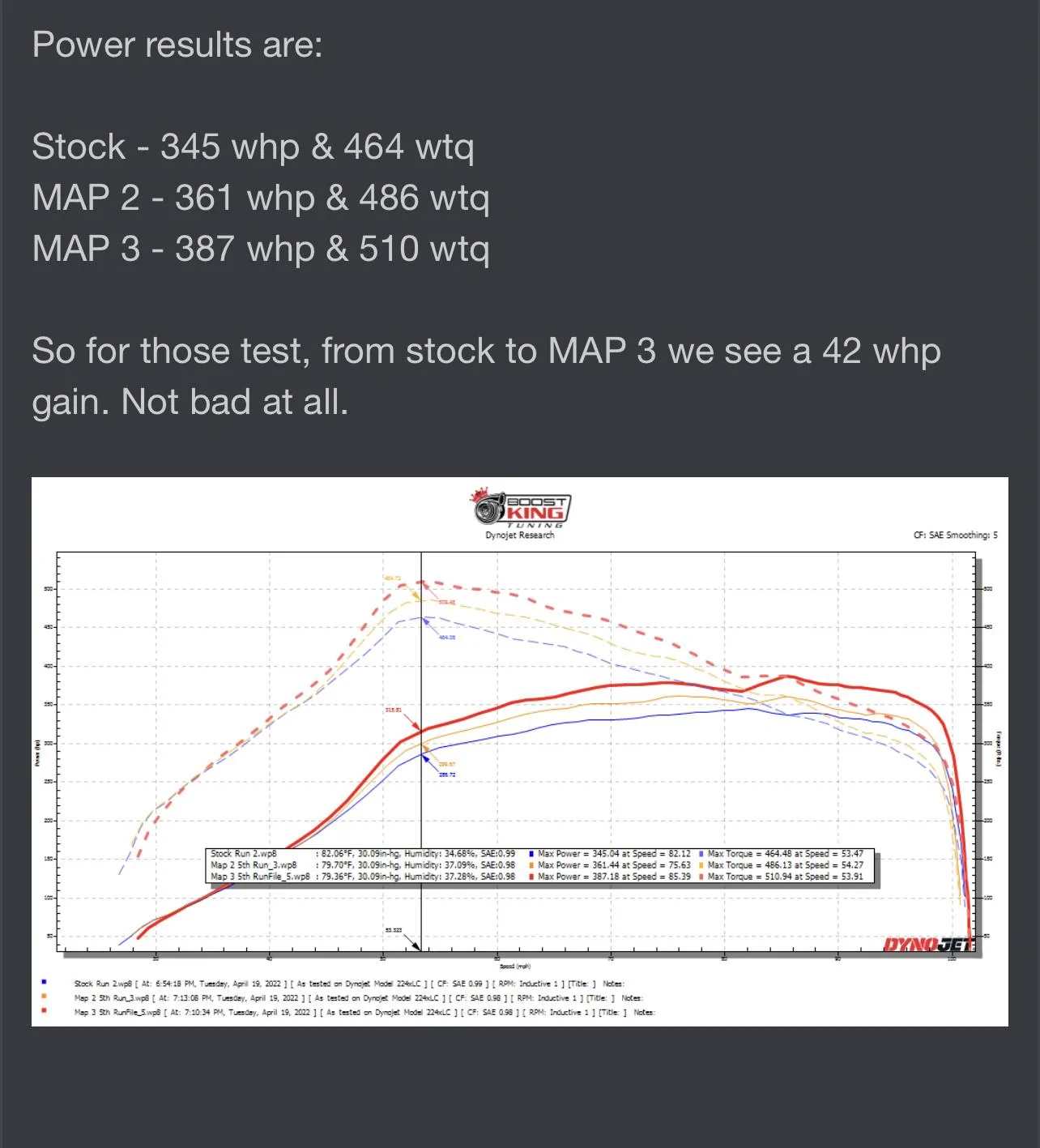

How did that JB4 tune work for you!!
It’s been great, I put 93 octane and ran Map 3 in sport and it was crazy fast. But on the Gas plus side I run Map 2 with 89/91 octane and gained 1-2 mpg then before. I feel it evened out my MPGs back to stock as I lost a few when I leveled her and added the 35s. I get aroun 17-18 70% highway now.
I think there was a guy that dynod some good numbers with just this tune, no mods

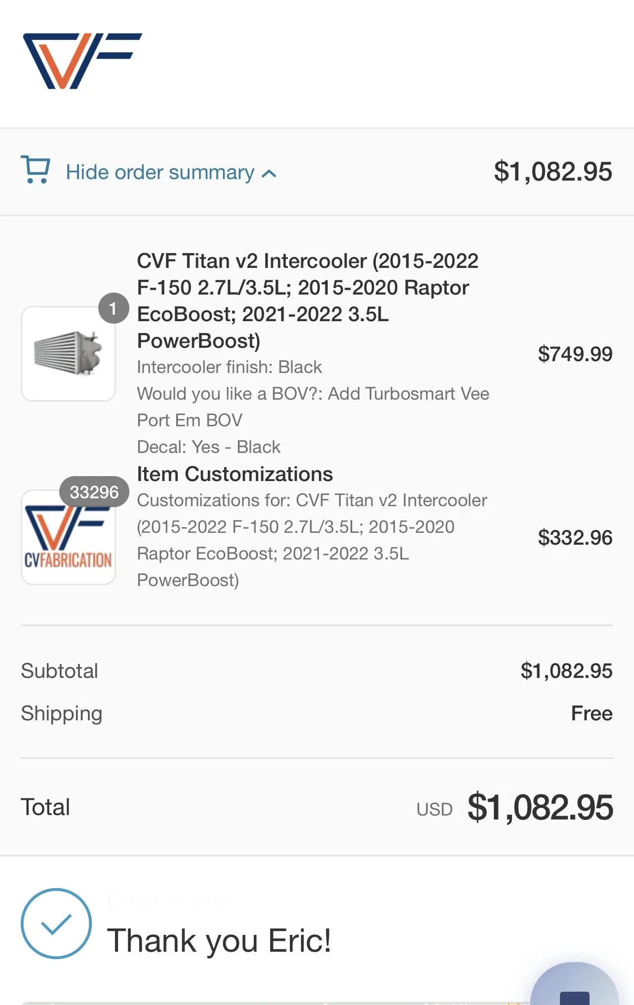

Just ordered these bad boys! Happy B day to me! Hoping to put them on in august
