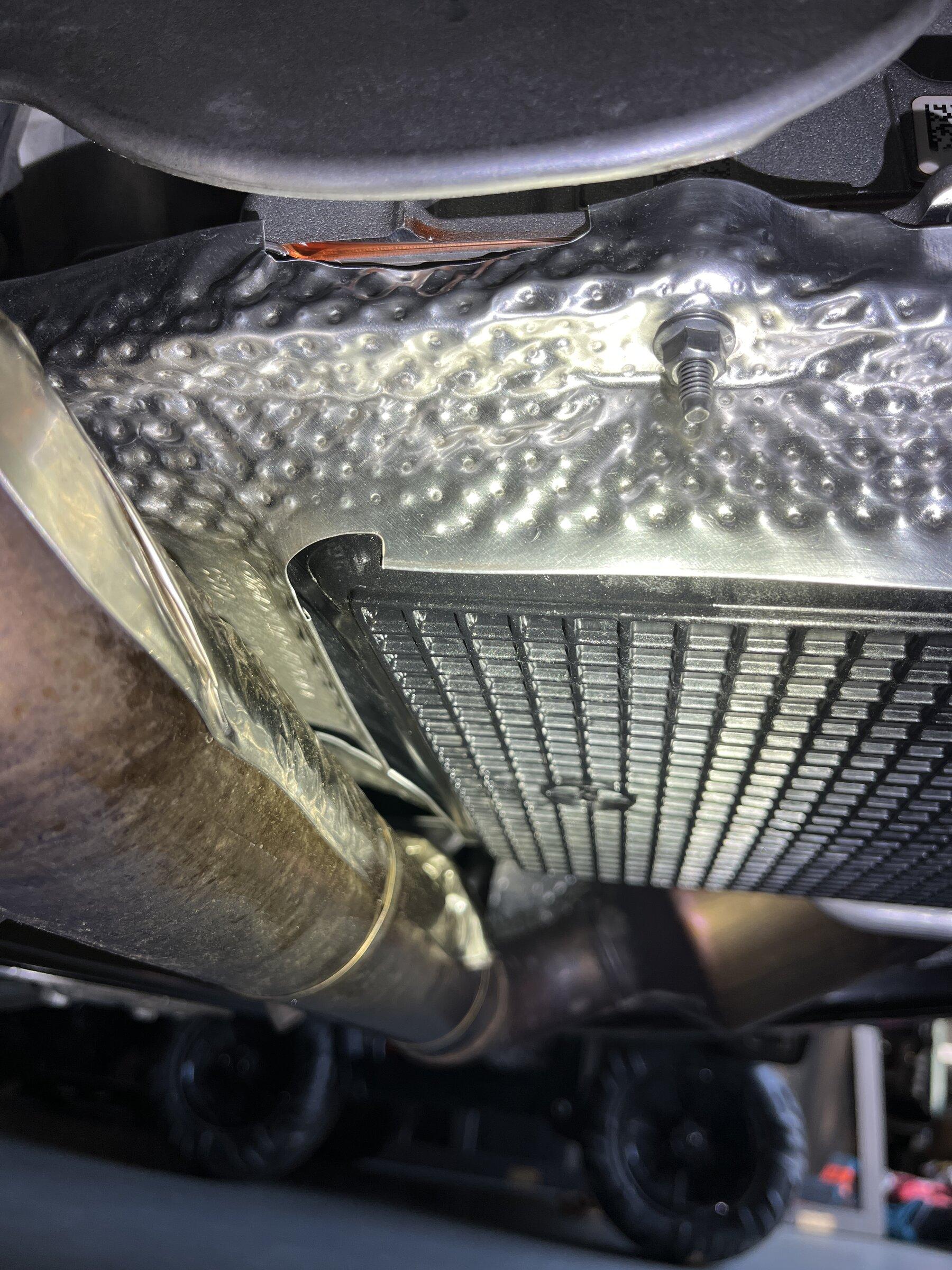

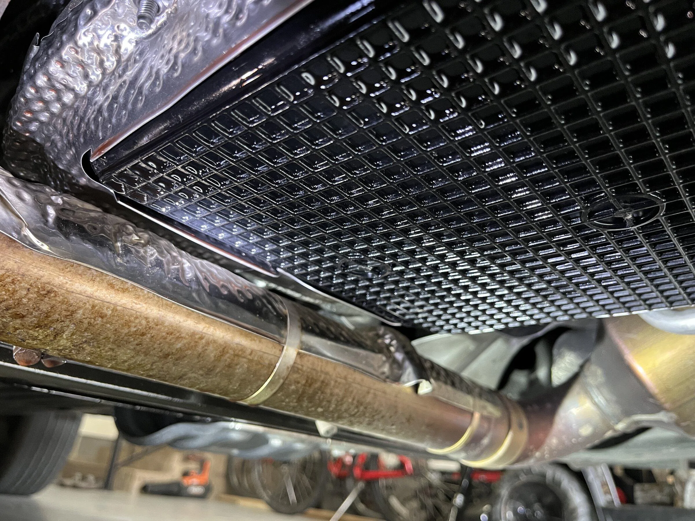

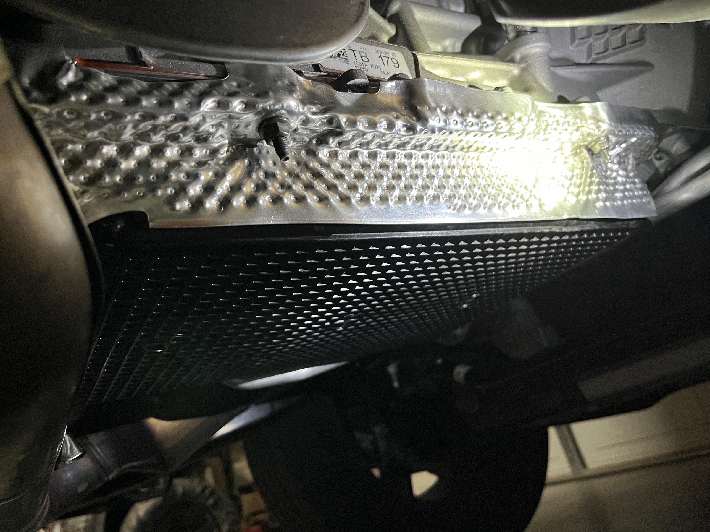

Here are some photos.

Have them pull the shield and look for a cracked pan. Mine was replaced at 350 miles. Could not be seen until warmed up.
I just called them and relayed what you said, they said they are going to look at that now. Let's hope they actually do. Thanks for the suggestion.

I agree with you. While I was questioning the Forman and Service Manager yesterday, they did mention that they were uncertain if the tech followed the proper procedure for checking the level and filling it. I asked them to drop the pan, check for issues and metal shavings and to refill to the proper fill level. They assured me that they did that however, I don't believe they did at all even though they wrote it up on the service ticket because I made them for documentation purposes.
Makes sense though, after they filled it, the leaking issues began and have continued. I'm pretty sure something is cracked or some seal is broken which is causing it to leak when pressure builds in the transmission. I travel over a few mountains to get home so I can see how above normal (flat road) pressure could build cause it to continue to leak if it was initially overfilled and something blew.
