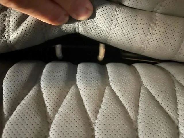

I took this short video of my KR's driver's seat today. I didn't dig very far into the seat ....but the white parts look to be tubes of some sort.... maybe for the inflatable lumbar or ventilated seat back ??? Not sure. But I definitely do not feel mine when sitting in the seat. And they are very well covered / protected by the seat cushion......

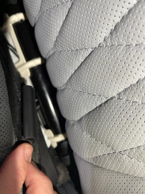

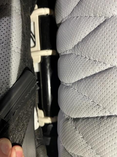

Thanks for the video, that was helpful. It almost appears my seat cushion is not back as far as yours. Also after digging a little more I found straps with clips on them that are not attached to anything. I cant feel where they would attach but they would defiantly hold the seat in place. i attached pictures. Could you see if you have them and they are attached.

it Would appear based on the clips you found that you bottom seat cover is not properly installed. The clips are supposed to go around that bar and clip underneath the seat.

I had to have my driver's seat bottom leather replaced and noticed when my seat would go up to my ride height that I would fell a slight drop and could feel stuff near my lower back buttocks.
The white clips hold the seat bottom on the frame. There are four, two outside edge and two in the middle.
The black plastic clips you are showing in your picture wraps under the seat and snaps onto a frame bar. When not in place your bottom seat cushion can slightly move out of place and down to low in the seat frame. Have the dealer install those clips and all will be better!
