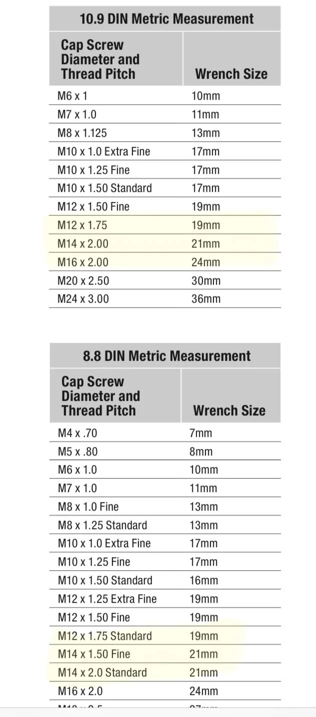

14mm? More like 21mm?

Lug nut socket size 21mm\13/16", thread size M14x1.5, toque to 150 lb*ft\204 Nm
