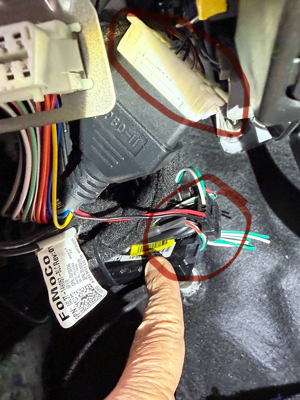

The obd2 port itself looks like it’s wired into another OBD2 port. I can see how to cut out the LoJack but I’ve never seen two OBD2 ports before. One is male the other female.
Ford F-150 LoJack removal IMG_0210
The OBD2 port connector just pushes back through the metal slot by depressing the 2 tabs. They've backed out the factory one, added their jumper to it, and put their jumper OBD2 connector back into the factory slot.
First things first, unplug this and make sure the truck still operates fine
Ford F-150 LoJack removal 1741993353717-e3
It looks like this is simply a tracking device and not connected to anything else.
If such is the case, just remove their junk and put your OBD2 connector back into the factory slot
Ford F-150 LoJack removal 1741993502495-vh

The white OBD plug that I’ve marked ”A” has only a few wires coming to it. The only plug I’ve found that’s fully populated is the white main OBD. I can’t seem to locate the OEM OBD plug.
Xs = junk they added, your OBD port is checkmark yellow

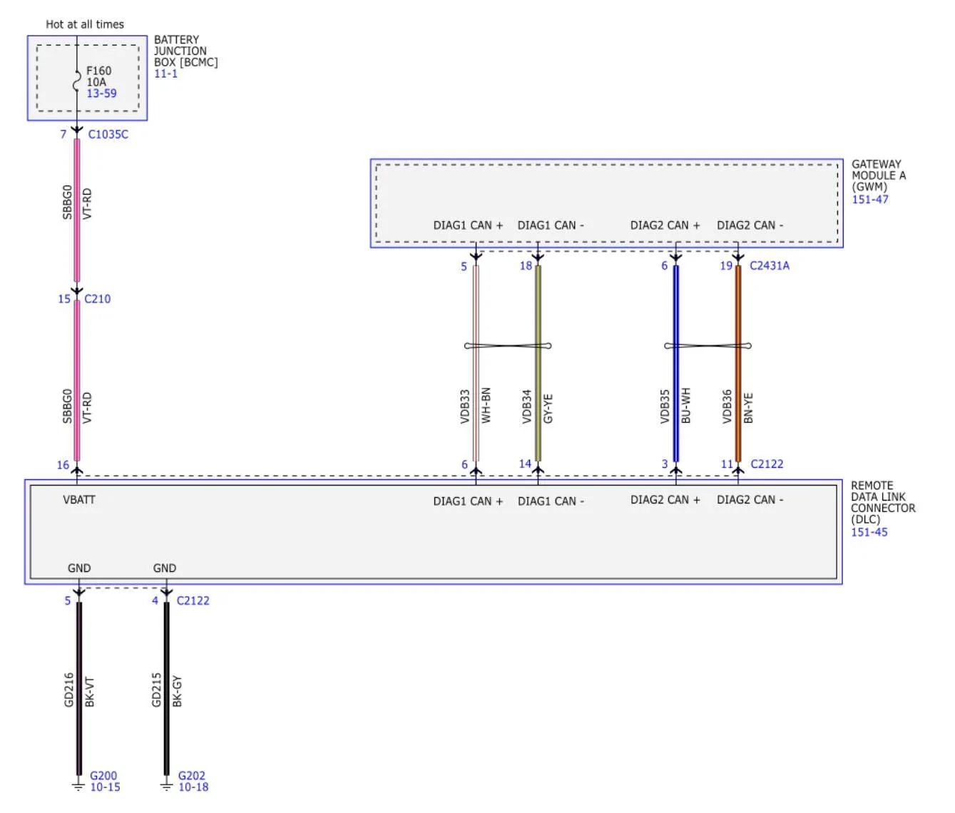

That’s what I would think, but do you see that there’s only around five or six wires coming to it? Is that right? I thought the plug should be fully populated with wires.
Power, 2 grounds and 2 can bus networks

So the OEM OBD2 port has only five wires going to it? I’m amazed. That’s what was throwing me. I was expecting a fully populated plug. The LoJack plug has a full compliment of wires that I guess simply go from nowhere to nowhere.

That’s what it is. I took it all out. The five or six wire OBD2 port cause me to doubt the original port. Everything works great now.
