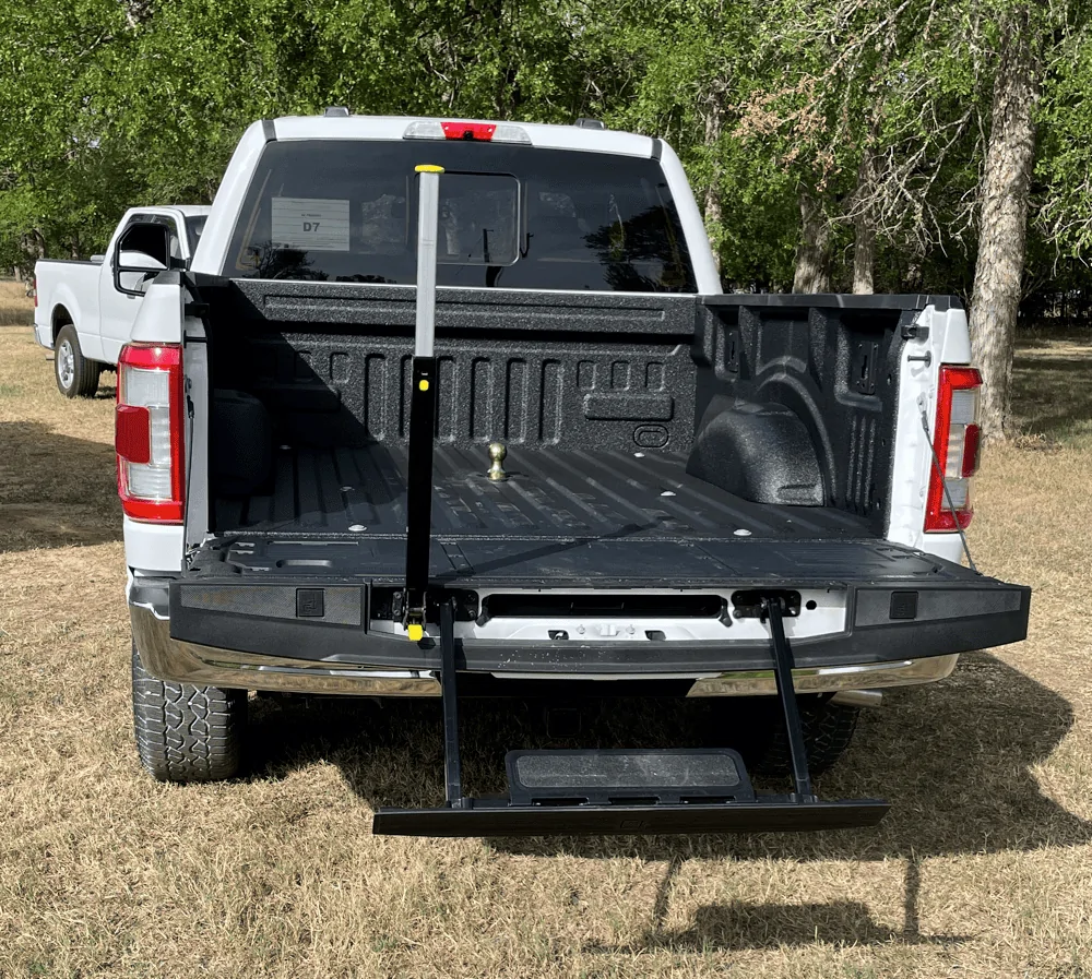

I know, why you brining a thread up from the dead. Well, I wanted to convey the info I received from my local LineX Dealer as not all of them as informed as he is.
More just FYI - apparently not all Line-X dealers use the same procedures.
Mine was applied without removing the tailgate or any electrical connectors (I have the fully-powered tailgate), they showed me how they (Line-X in Austin, TX) lower and support the tailgate below horizontal for the required access to mask, prep, and spray.
A beautiful job, the coating wraps over the metal edges of the bed and tailgate just as it should, no issues whatsoever.
