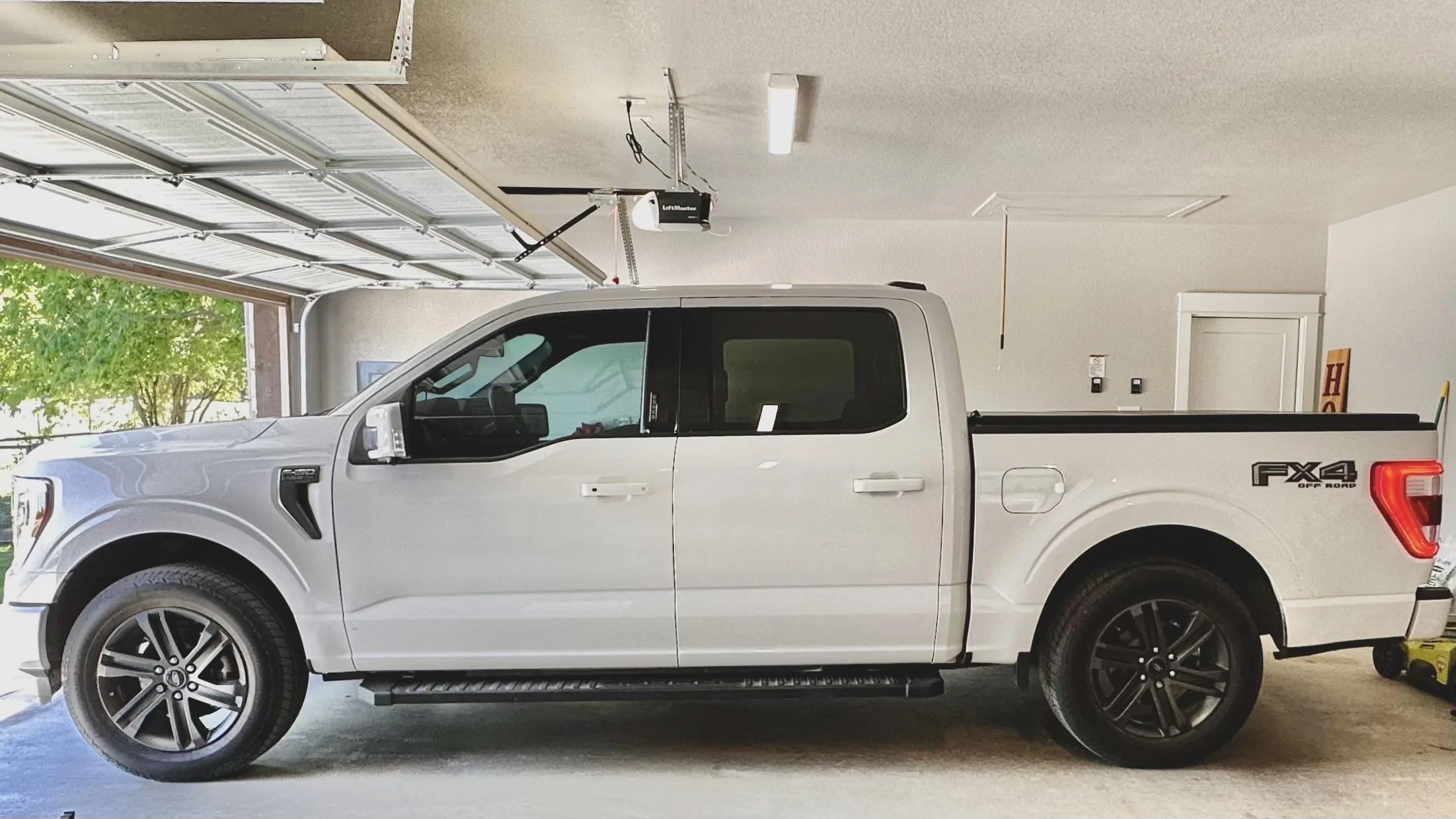

Ford F-150 Level with 1” Drop Shackles & Axle Block Removal IMG_2498

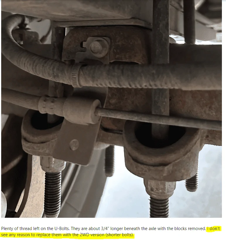

Axle Blocks Removed
Ford F-150 Level with 1” Drop Shackles & Axle Block Removal IMG_2499
Plenty of thread left on the U-Bolts. They are about 3/4” longer beneath the axle with the blocks removed. I don’t see any reason to replace them with the 2WD version (shorter bolts).
Geometry change resulted in a 2.25” total drop in the rear and 1” raise in the front. Still has about 1.5” of total rake for light duty towing and loads.
Ford F-150 Level with 1” Drop Shackles & Axle Block Removal IMG_2500
I like the look a lot better (stink bug wasn’t doing it for me…) The steering feels slightly lighter and more responsive with the angle change as well. Suspension isn’t as floaty/bouncy with normal driving, more planted. I’ll go do some off roading this weekend and see how everything feels. Easy, pretty cheap mod if it’s your jam.

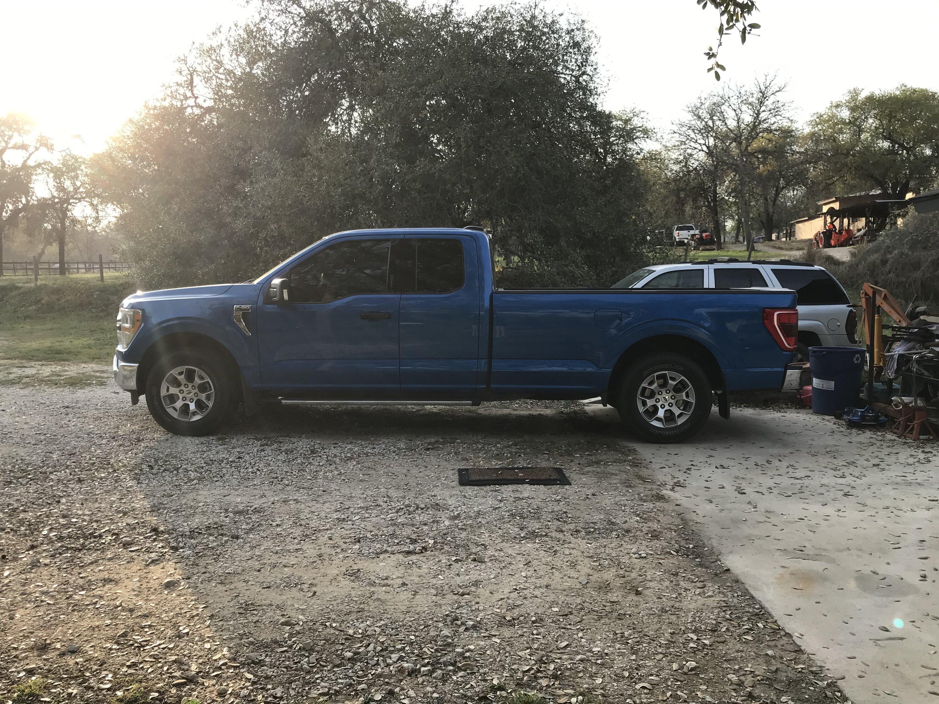

I did the block removal and shackles a few months ago.
I started with the shackles (‘cause the shorter u-bolts hadn’t arrived yet.
Shackles (1.25” MaxxTrac) only provided me with a better view out the rear window, and the little drop was noticeable immediately once I got in for a ride.
A couple weeks later, removed the blocks and changed the axle stops to the 2-wd version.
This made a bigger difference overall.
Truck is nearly level
Truck feels heavier in the back, and loose gravel and washboard not nearly as “hoppy”
Front came up about 1/2”.
Absolutely no ill effects or vibration, more comfortable to drive since I’m not always going down hill.
Never liked the ‘stink bug’ of most pickups, particularly a 4x4.
(IMO, 4x4 should be dead nuts level, but not necessarily raised.)
I should note that I have a SuperCab with 8ft box. (164” wb), so some weight up front moved to the back, and it seems nicer to drive.
