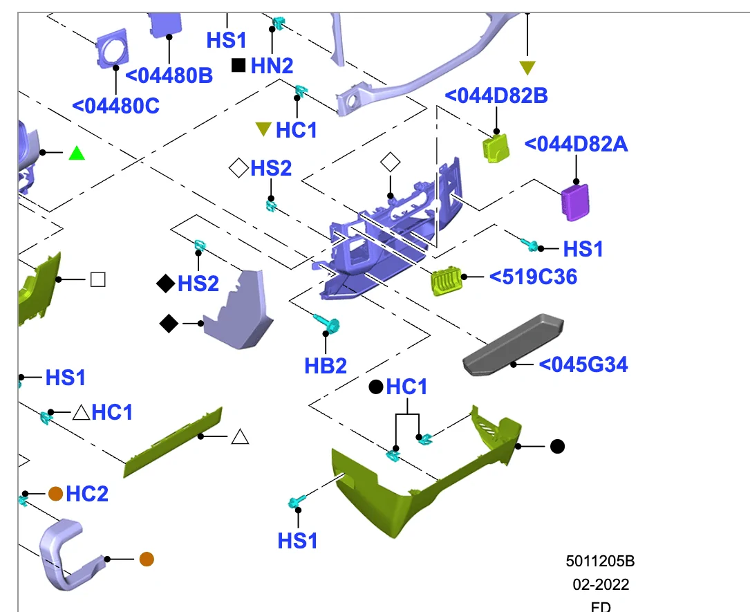

I have 2021 f150 lariat column shifter it has jump seat
I think someone tried to swap the center console but no didn't complete the project
now I want to return it back to jump seat
please see the photo below
Anyone knows the missing trim number ?

also the jump seat missing this part

You need a few pieces it looks like. Go to parts.ford.com and type in your vin.
Look for Instrument Panel Trim
You will need the White diamond piece the two side wings (black diamond) the rubber mat 045g34, and the black circle lower trim plastic.
Ford F-150 Jump seat, missing part 1693087427794
