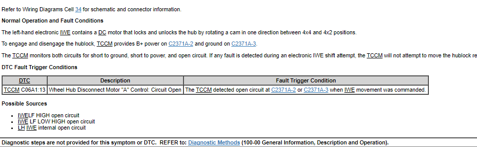

Got my truck back, IWE confirmed to be the issue and replaced. Sound completely gone. Attaching tech notes.
Ford F-150 IWE Grinding 20230324_174924
