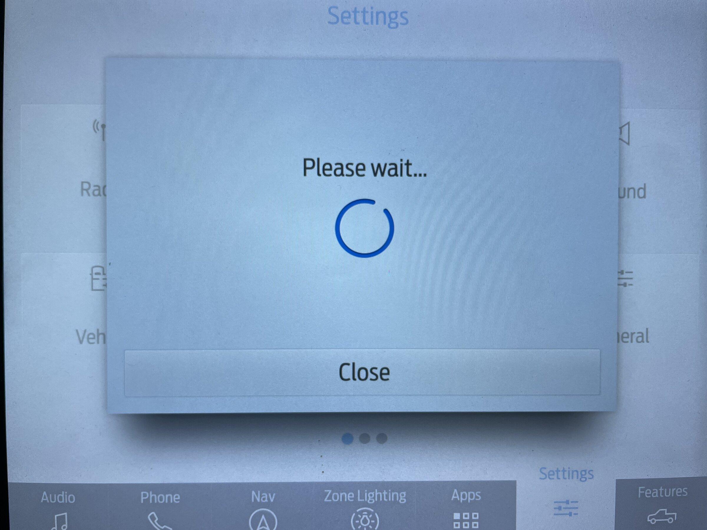

Same issues here with ACC and SSR. It’s very frustrating. Also having issues since the update with “Please Wait” screen that keeps cycling and with the “Ground Fault Detected” screen popping up. Hopefully the fixes come soon.
