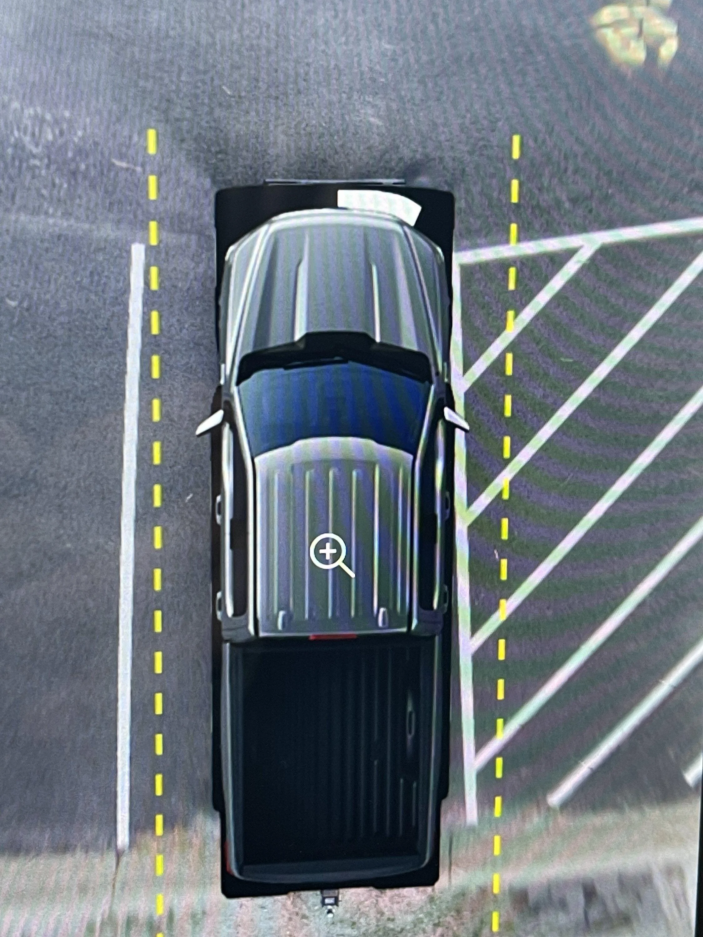

I currently own a 2021 f-150, just last night I got the message front park aid not available sensor blocked, see manual. The sensors are perfectly clean and look perfect, any suggestions? And I looked up a part number and it’s hard to find one with chrome bumper, if anyone knows please let me know, also, if I remove the piece between the grill and the bumper do I have access to these sensors? Or do I need to remove front bumper..

How do you reach the connectors. I went under the truck and cannot reach any of them up front, there are six sensors in the front, I have access to the passenger and driver fender sides, as for the front…. Do I need to remove something to have the access??
