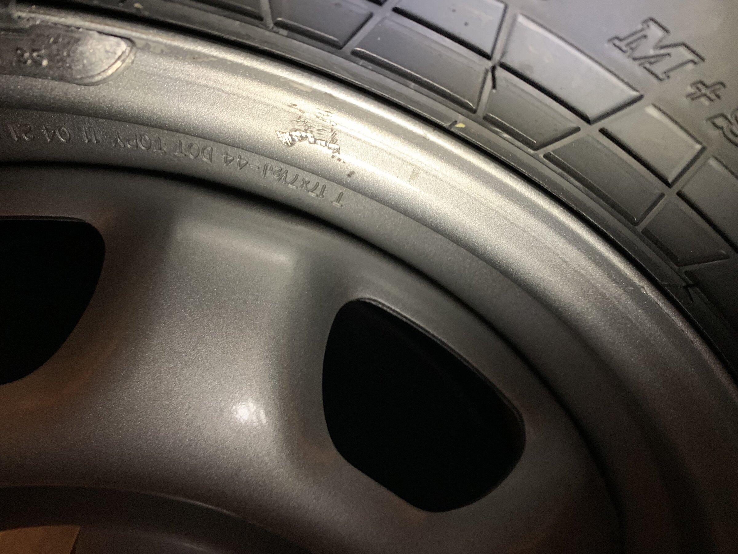

I'm not sure if I am nitpicking and this is the first time I have had steel wheels with this type of crimp on weight, but is this normal?
I had some paint damage during a tire install. It looks like either the wheels were damaged when new weights were installed or when old weights were removed.
Damage during install (no rust)
Ford F-150 Is this damage normal? Wheels damaged during tire install IMG_0930
Wheel damage probably from old wheel weight (little rust)
Ford F-150 Is this damage normal? Wheels damaged during tire install IMG_0936

Oof, could be weights being removed it's tough to say. The problem is getting into a 'discussion' of prove it wasn't there already isn't worth the head space. I would get a small "Duplicolor" touch up pen/brush and youtube touch ups and you will know it's there, but nobody else will. Stuff happens although it's still a bummer. We still don't have a recall done on our Mach-E as each trip to the service department comes with its own set of risks. Inevitably I'll pick my vehicle up and find something. Yours does look like an easy touch up for sure.

That's pretty standard for clip on weights. Hammering the weights on and removal will typically leave some small scuffs. Just the nature of steel wheels and clip on weights.

Always request the weights are applied to the other side (inside) of the wheel. Who wants to see them even if applied without scuffing up the rim....

While you can do a single clip weight, it effects the quality of your balance. You'll typically see more vibration as you're not able to balance against side to side movement of the tire. If you're worried about the appearance that much, some aftermarket wheels with tape weights will look and ride better.
You might be able to get a shop to do an inside clip weight AND tape weights just inside the spokes, but shops don't usually throw tape weights on steel wheels.

I'd touch up the paint as mentioned above, since you are in Indiana and not worry about it any further. I would also avoid that tire shop, since that's some amateur hour work.
