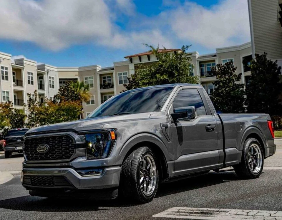

Can also order up gel over lays from ISFP https://www.isfpcustomemblems.com/shop
I have his grill and tailgate ones on my truck. They are a nice quality overlay. You will be waiting 6 months to get them so be ready and patient as there will not be weekly updates or anything of that sort. Be sure to watch the install on their site or might even be some out there on youtube. My recommendation for install is to use a piece of blue painters tape over the emblem (it's a muti-layer piece) to hold it together while you remove the white paper backing. ISFP does ship them with a small piece of plastic over them but I recommend adding the blue tape as well.
