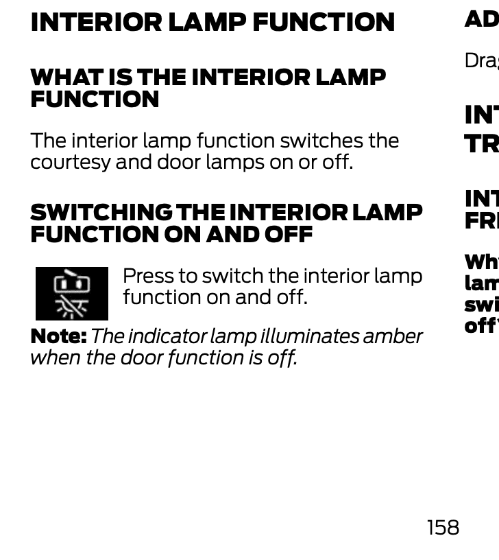

Sounds like the switch on the overhead console has been turned off. I 've done this by mistake.
WHAT IS THE INTERIOR LAMP FUNCTION
The interior lamp function switches the courtesy and door lamps on or off.
SWITCHING THE INTERIOR LAMP FUNCTION ON AND OFF
Press to switch the interior lamp function on and off.
Note: The indicator lamp illuminates amber when the door function is off.
Ford F-150 Interior lights screenshot_218
