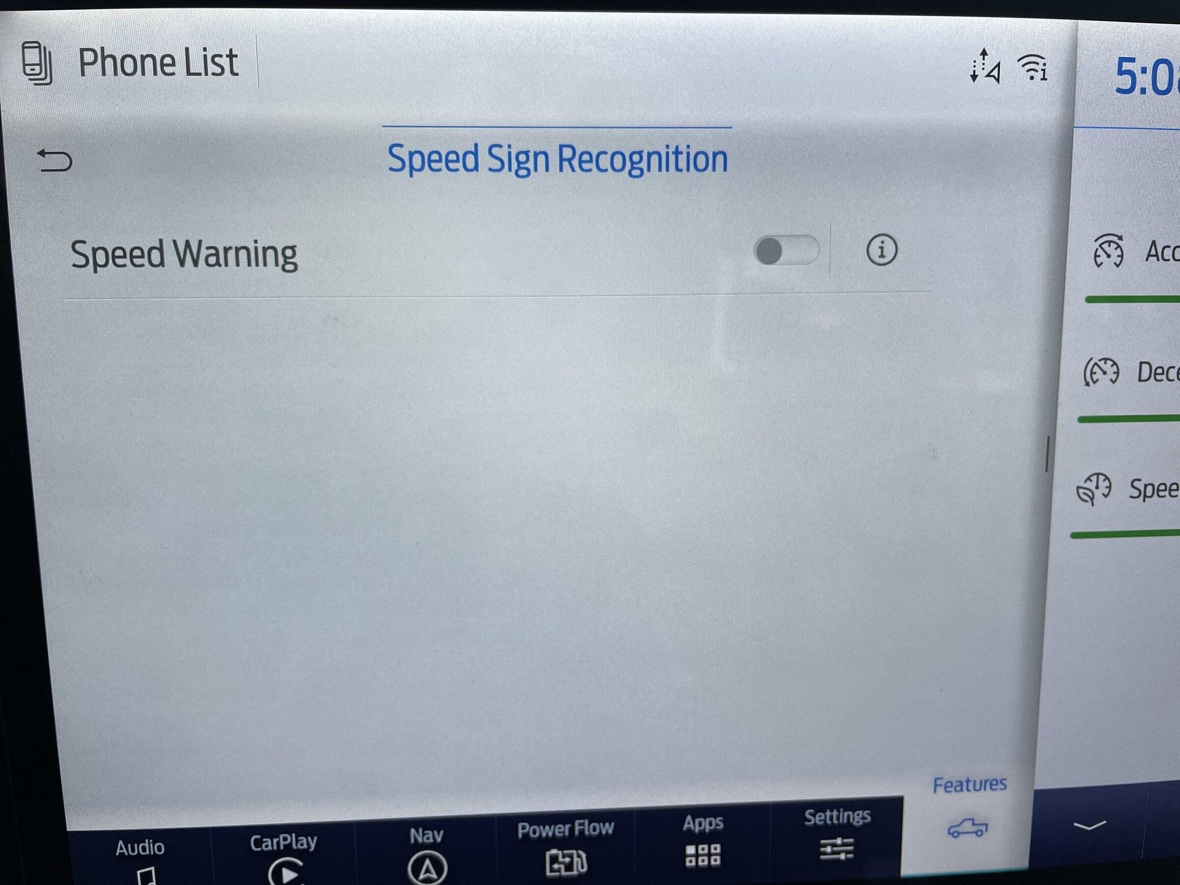

What PowerUP OTA version is everyone running that are having this SSR issue? I was at 1.6 with no issue since late September, and now after the 1.7.1 upgrade over the weekend, SSR is grayed out... I'm just curious to see if it has any correlation to the 1.7.1 update which seems to have various potential problems based on this site and other forum site posts.
Just as an update, the SSR is no longer grayed out in the menus when I select Intelligent Cruise mode, but when it is selected, it still links to the Speed Warning screen....

This is completely theory but I wonder if Ford is tightening tolerances prior to BC update. I’m on 2.1.1 and recently started getting this error, as well as having Lane Keeping disable more regularly on me. Given that others have had luck with a camera recalibration I am curious if perhaps the spec has gotten tighter which means for cameras that aren’t perfectly calibrated there are more regular errors being thrown causing these issues. Again completely made up theory, but

You may be on to something but for the fact that a post up a few was from a gent who got the camera recalibration TSB applied and is still having issues with SSR. Maybe there is yet another process as that would not surprise me... It just seems like every time I get into the truck, something has changed but there has been no up/download activity to the truck per my network monitoring stats. Maybe 2.1.1 will come for me soon and I can see if it helps at all.

Dang…. I was hoping 2.1.1 was the light at the end of the tunnel. Does your Speed Sign Recognition screen also link to the Speed Warning like I showed above?
