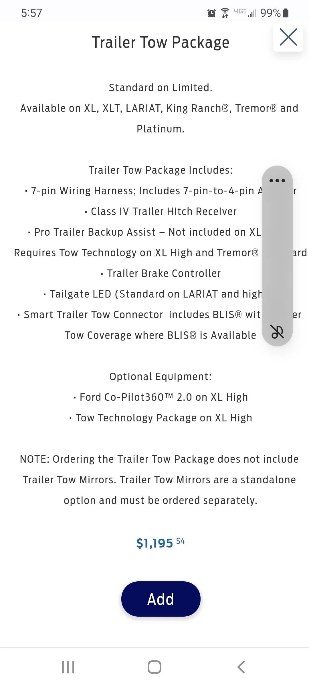

Well, according to Ford....
Ford F-150 Integrated Trailer Brake Controller Screenshot_20220417-175757_Chrom

I believe you got the 53b "Class IV Trailer Hitch," which is what Mtnman1 said. 53b is what comes equipped on the 301a.
Ford F-150 Integrated Trailer Brake Controller 1650238126617
53a "Trailer Tow Package" is a different kit.
