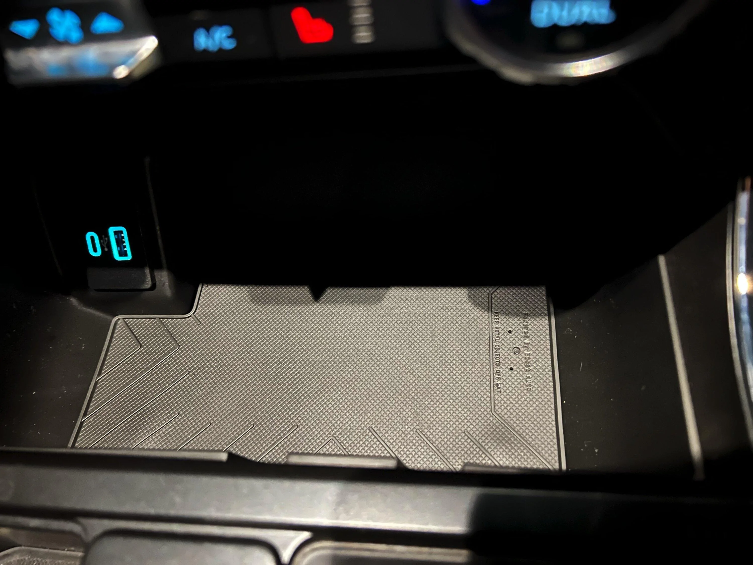

Hi all,
I finally installed my Boost Auto Qi charging pad that Santa brought me. The pad replaces the rubber mat in the forward-most center console tray. Installation is a bit painful as you have to remove several pieces of trim and unbolt and slide back the center console. The charging pad takes a standard 12-volt input so you do not lose one of your USB ports. I ran the positive and ground wires back to the fuse box and used a fuse tap on a switched circuit.
Ford F-150 Installed Boost Auto Qi Charging Pad in center console tray IMG_0474

Can you re attach. It says not available. I’d like to see what it looks like. Did you have to drill a hole for the wires?

Sorry, my first post had the pic upside-down.
