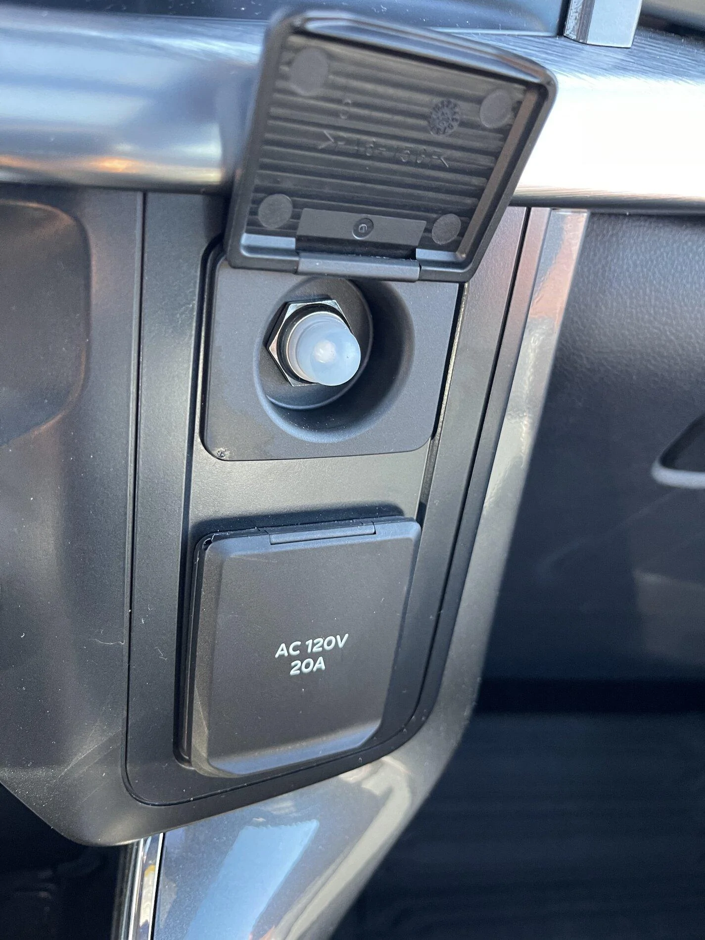

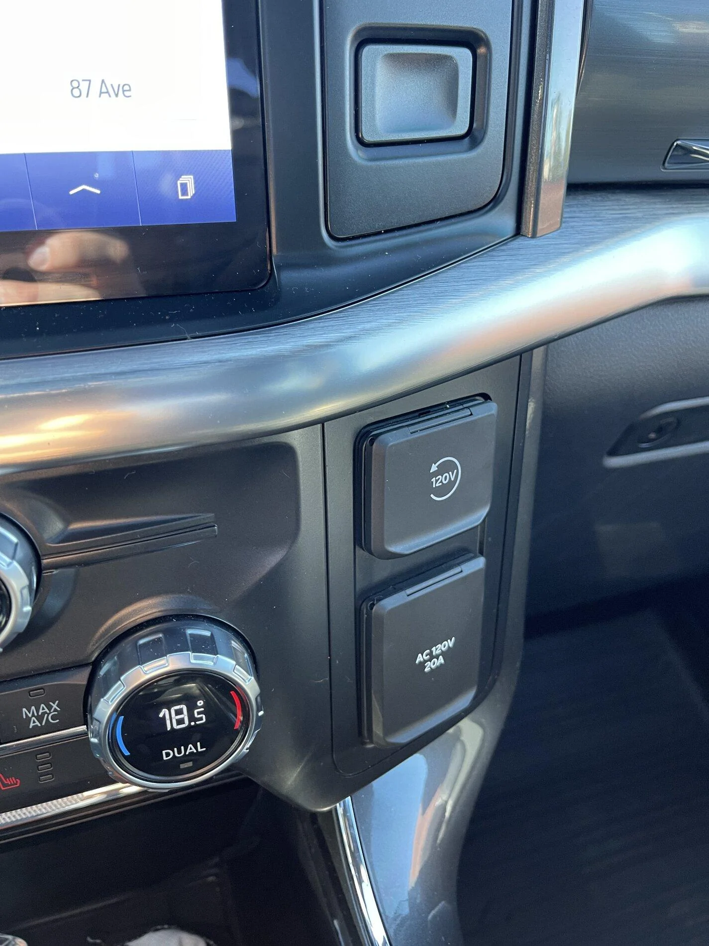

I need help identifying this thing in my 2021 powerboost.
Firsttimefordowner
Dan
Aug 18, 2021
Alberta
2021 Ford F-150 Lariat Powerboost
So I have been trying to figure it out online and haven’t had any luck. I took my truck to the dealership for its 1st oil change and asked some of the salesmen, then the service department, then they brought out the service manager. No one knows.
I thought it was an LED to indicate the pro power onboard generator is running, nope. Anyone here know?

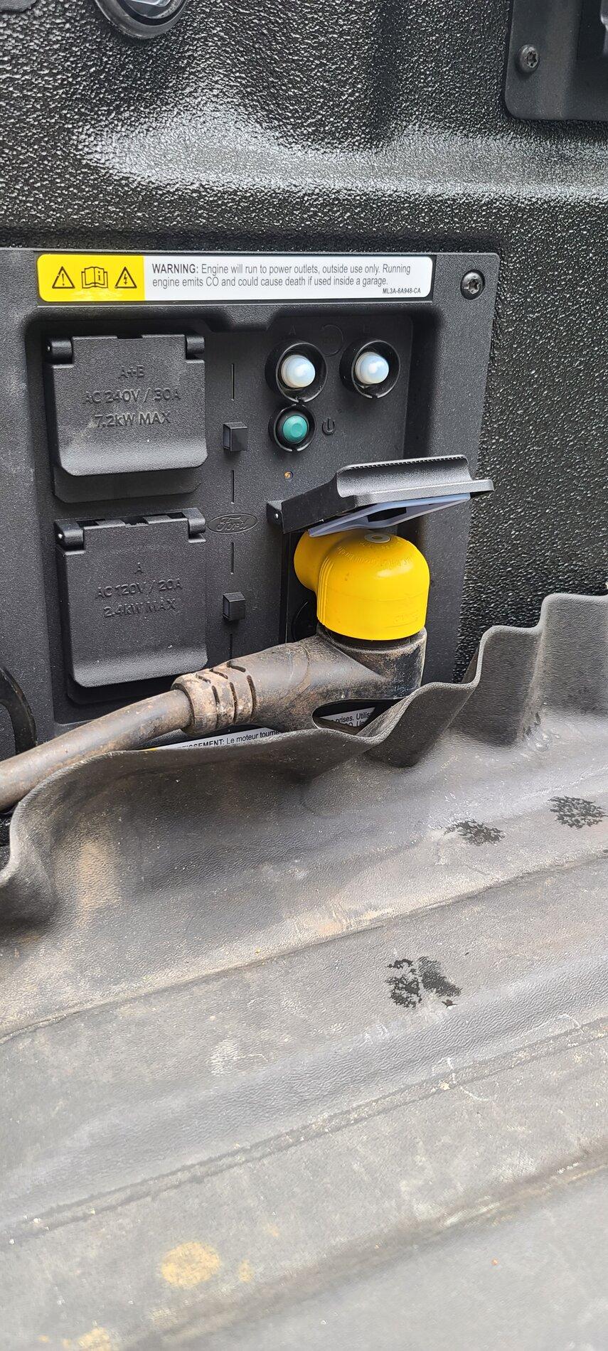

That is in fact the circuit reset for the interior 110V outlets. You will find 2 other resets in the bed of the truck next to the ProPower outlets there.
