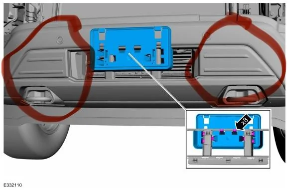

On the front bumper I have these two (circled areas) pieces on each side.
Are they bolted in at all or is it just a swift hard tug and they come out?

I was able to lay on the ground and reach up with my hand and squeeze the clips together and pop that mount off with zero damage.
