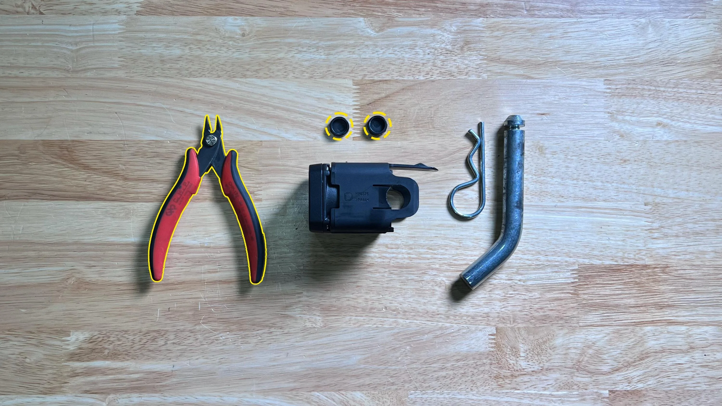

If you're concerned about theft of your HitchMount LED Pod, then this simple modification can be performed in just a couple of minutes to save your investment!​
Requirements:
• C1/C1R HitchMount LED Pod
• Cutting Pliers
• Locking Pin
Ford F-150 How-To: HitchMount LED Pod Trailer Pin Modification | Diode Dynamics ybUnwR
Cutting Pliers | HitchMount LED Pod | Locking Pin

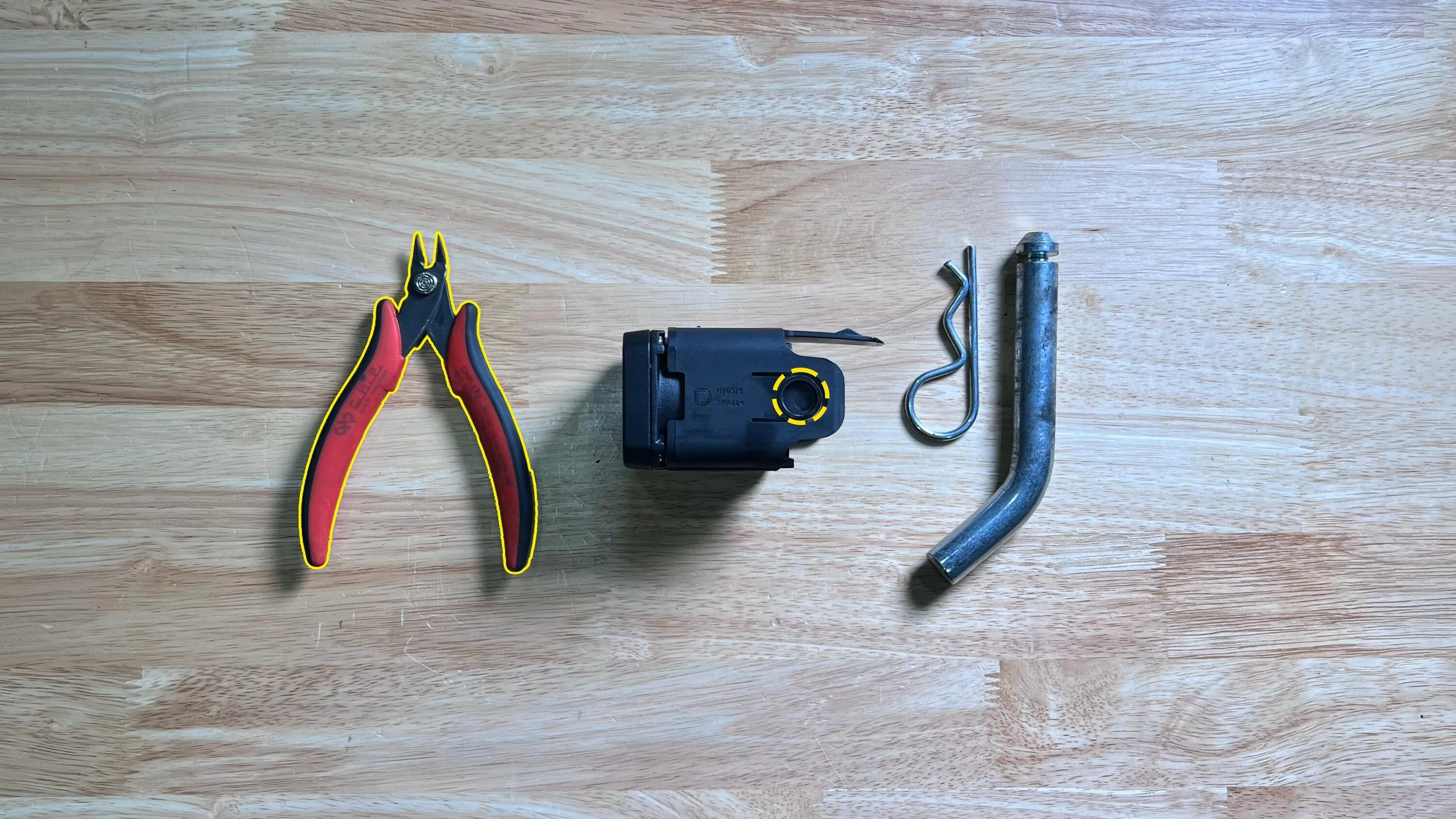

Ford F-150 How-To: HitchMount LED Pod Trailer Pin Modification | Diode Dynamics VtSDybo
Use the cutting tool of your choice to remove the retention tabs on our snap-fit housing

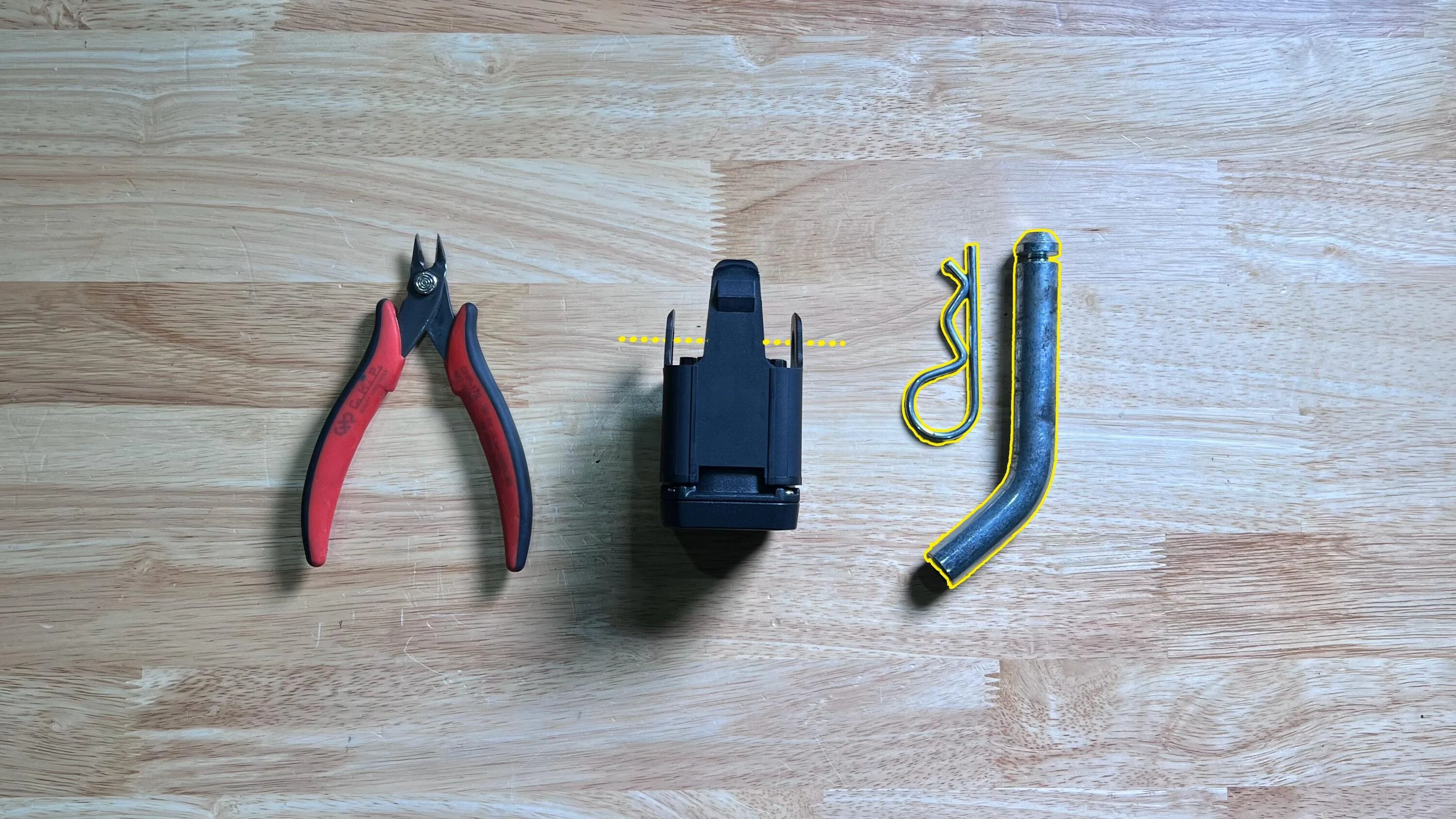

Ford F-150 How-To: HitchMount LED Pod Trailer Pin Modification | Diode Dynamics P9c4b77
With the snap-fit housing retention tabs removed, you can now prepare your locking pin

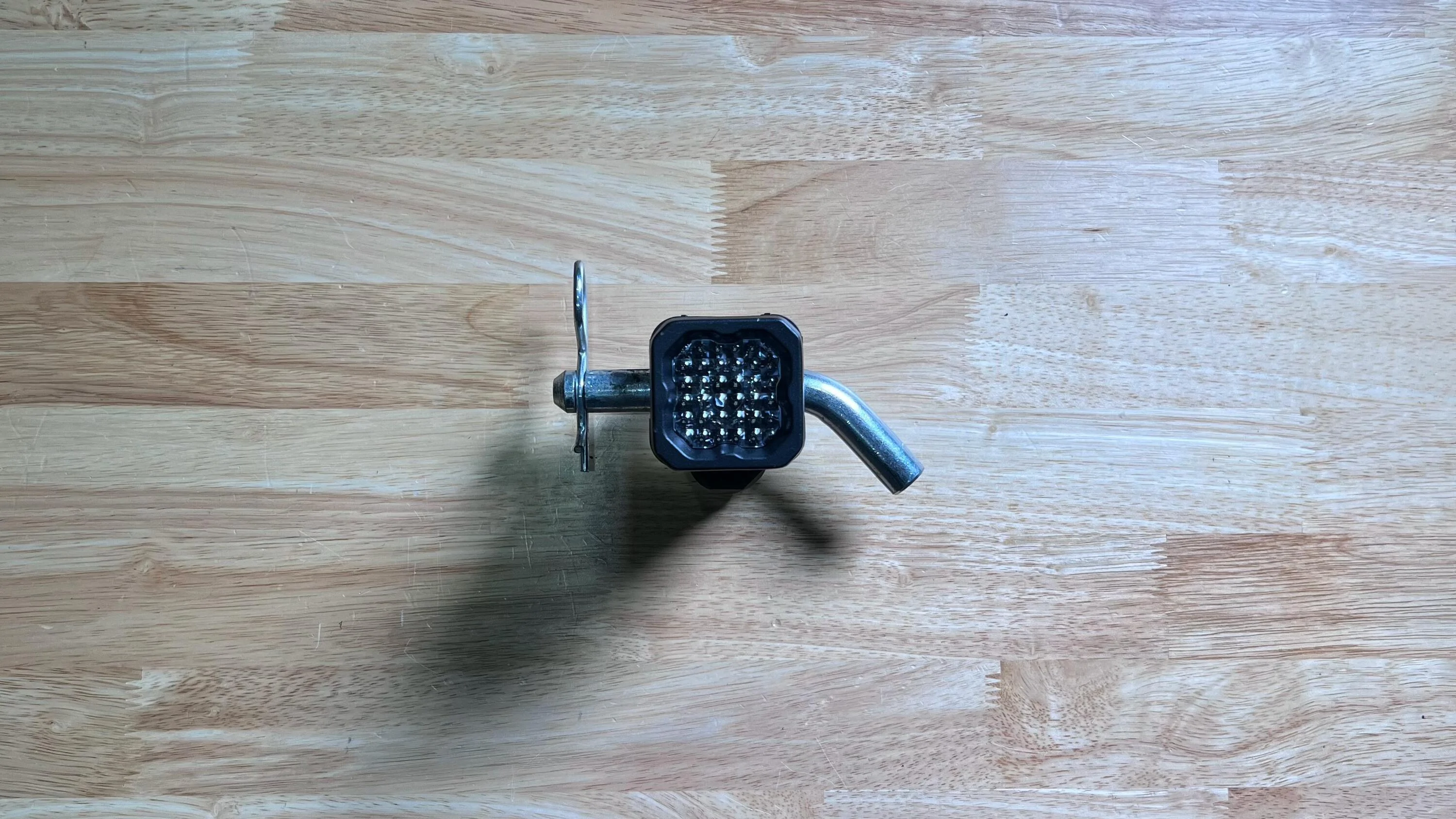

Ford F-150 How-To: HitchMount LED Pod Trailer Pin Modification | Diode Dynamics SVXCXDq
Security has been added to protect your HitchMount LED pod

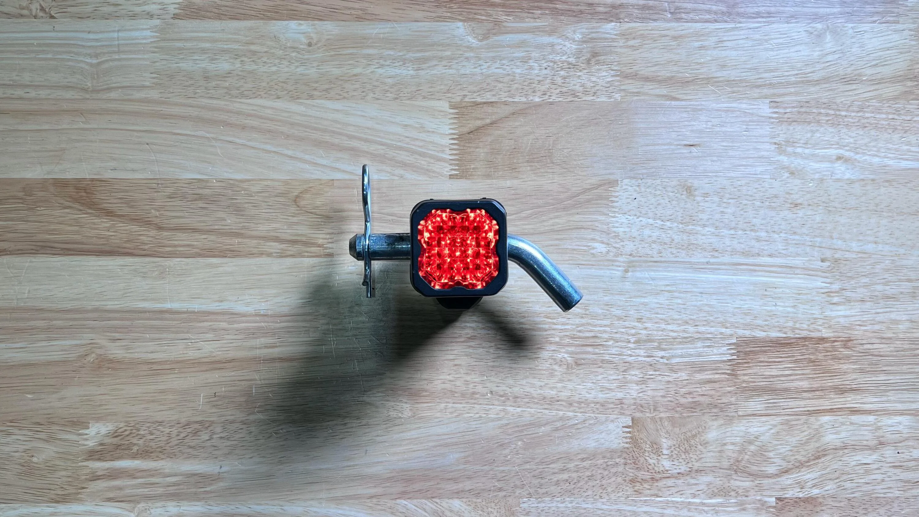

Ford F-150 How-To: HitchMount LED Pod Trailer Pin Modification | Diode Dynamics xmn1V9W
C1 HitchMount Red Running Light Displayed
C1R Includes an additional High Power Red 4th Brake Light with Safety Strobe Feature
