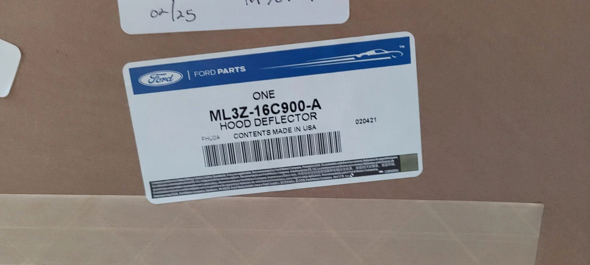

I don't see a lot of information online about the Ford OEM hood deflector for the 2021 F-150, so I am going to share the installation of the OEM hood deflector. It took my dealer two weeks to get the part after I ordered. Part number ML3Z-16C900-A. Cost about $100.

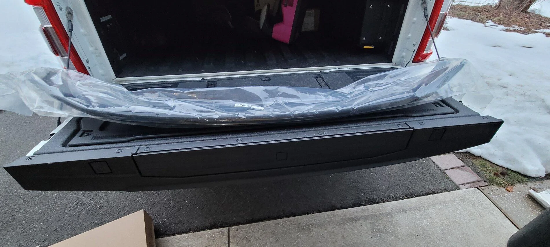

Here is the part #:
Ford F-150 Hood Deflector Installation - DIY Writeup 20210226_174002
Package comes with protective wrapping and hardware:
Ford F-150 Hood Deflector Installation - DIY Writeup 20210226_174110

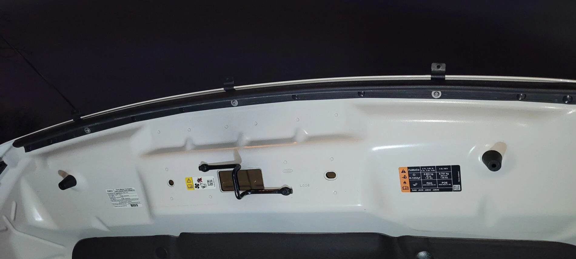

Open the hood and remove three fasteners on the weather stripping hood seal per instruction:
You will need a quality removing tool such as this one. The fasteners are locked in tight, I tried to remove it with the plastic tool and no go.
Ford F-150 Hood Deflector Installation - DIY Writeup 20210226_180015
Fasteners removed:
Ford F-150 Hood Deflector Installation - DIY Writeup 20210226_175952

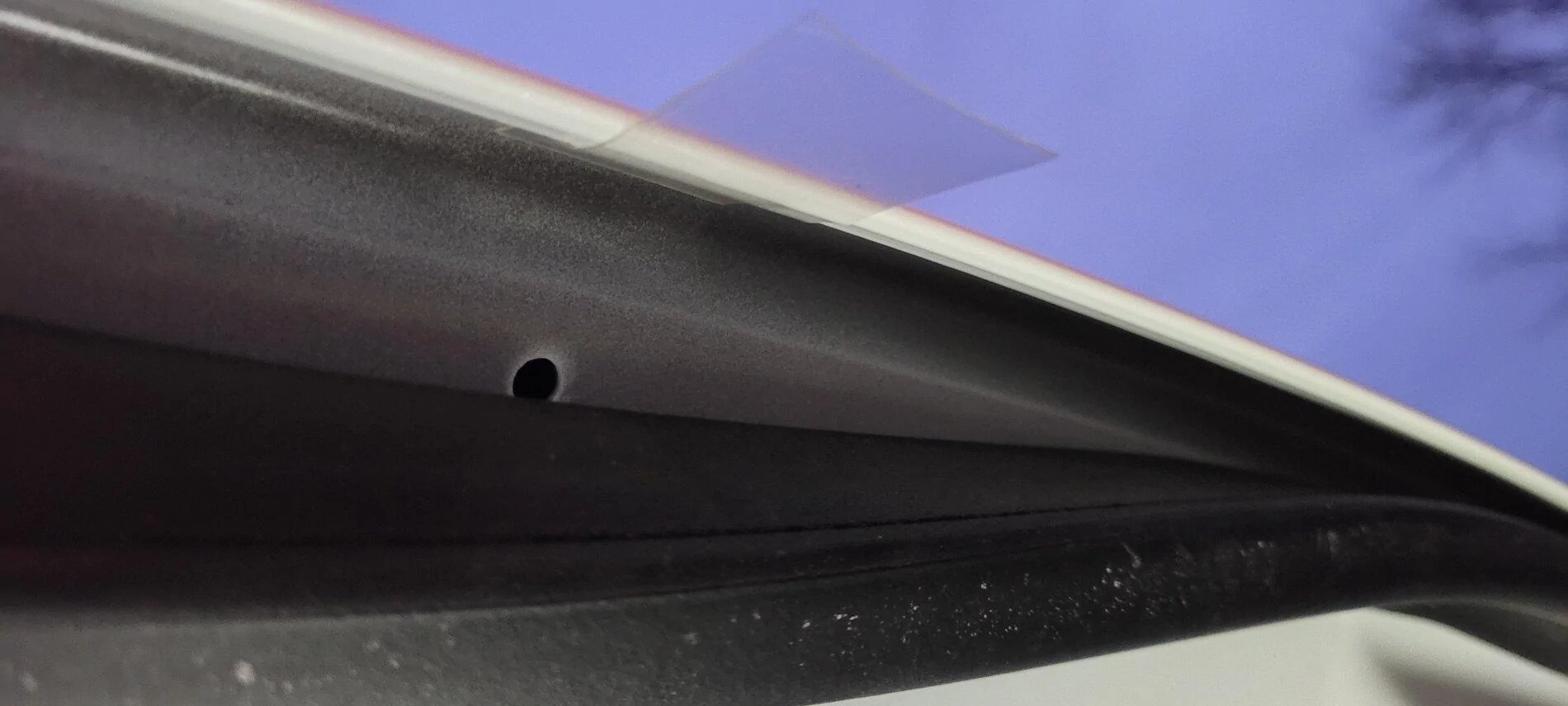

Clean the area with alcohol wipe (come with the package) and put on the protective sticker which should align with the hole as shown:
Ford F-150 Hood Deflector Installation - DIY Writeup 20210226_181047

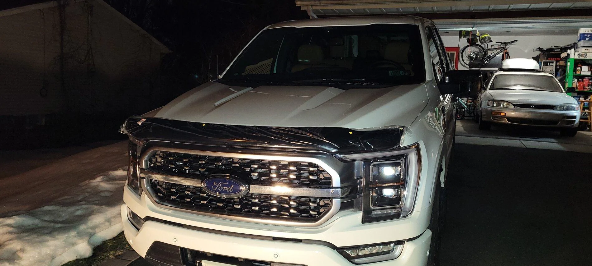

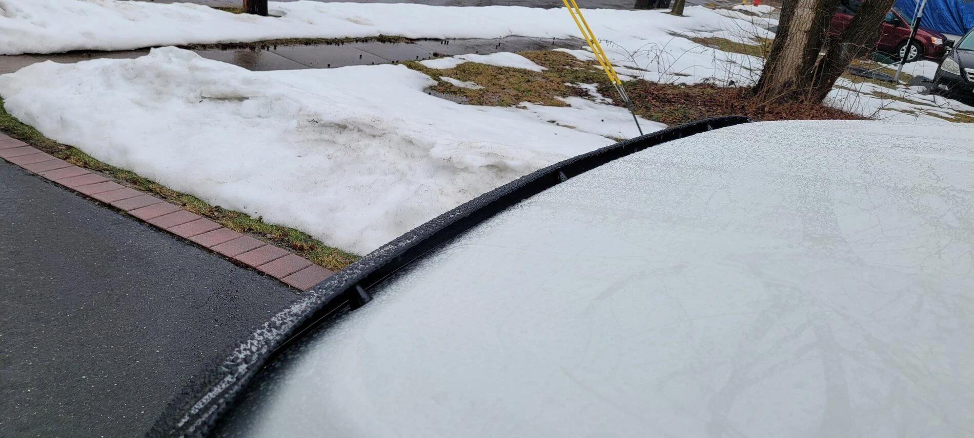

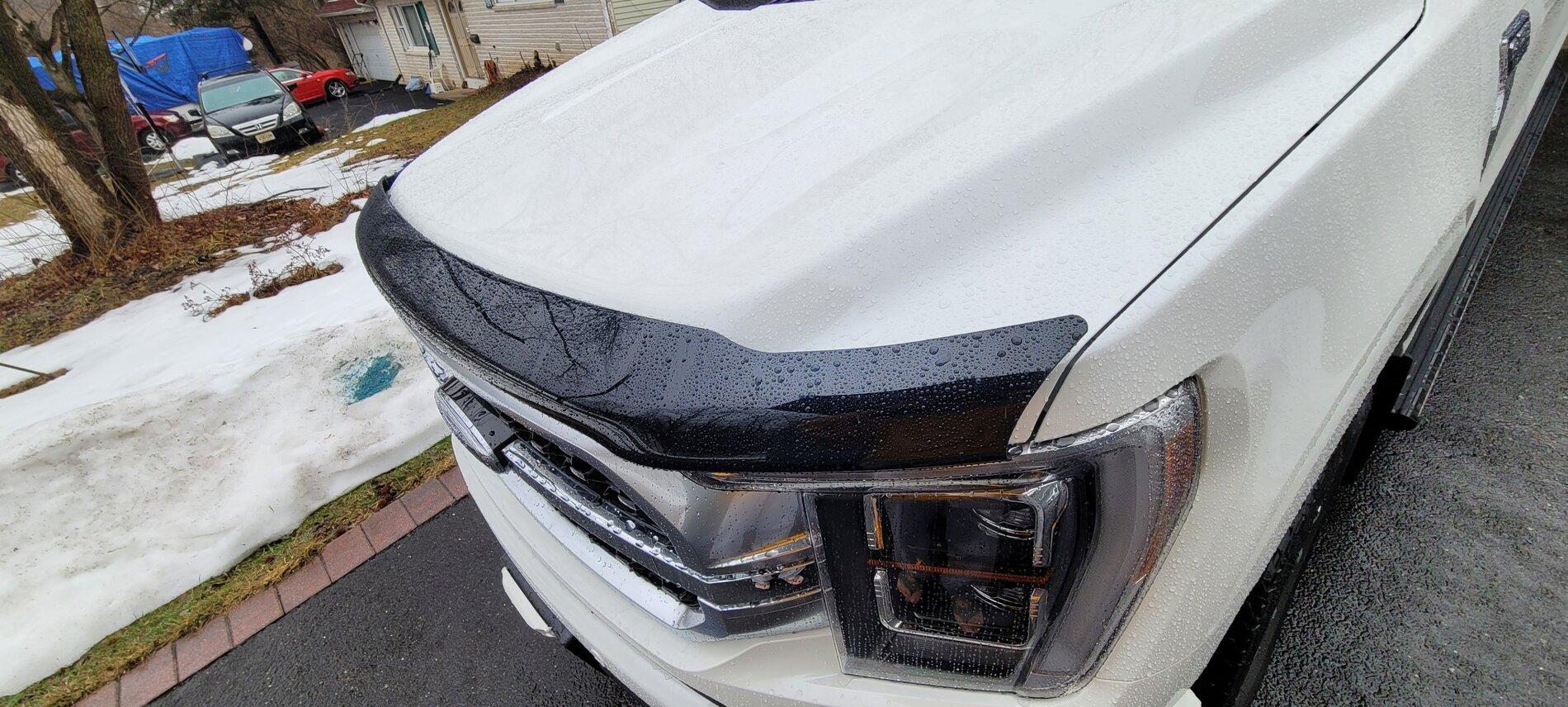

Installation complete:
Ford F-150 Hood Deflector Installation - DIY Writeup 20210227_100448
Enjoy!
Ford F-150 Hood Deflector Installation - DIY Writeup 20210227_100509
