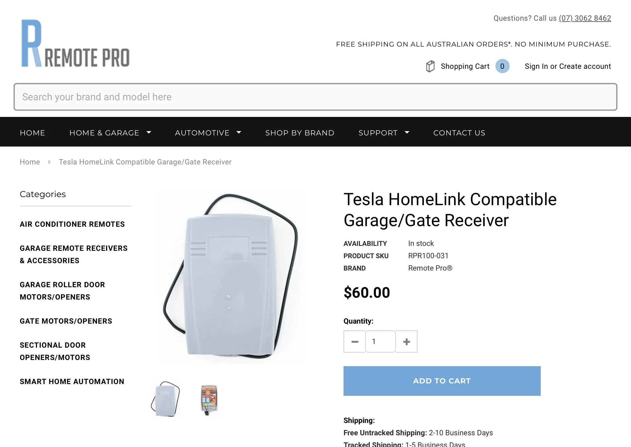

2. I purchased the following items. I have no affiliation with them but now I know for sure that these items work. They say you need to purchase the remote fob for learning, but I only did to be sure; I haven't tried it without the remote fob ?‍♂
Ford F-150 HomeLink install on non-HomeLink-compatible Rolling-Code Garage Door Opener IMG_4584
Ford F-150 HomeLink install on non-HomeLink-compatible Rolling-Code Garage Door Opener IMG_4585
I'm in Australia but there should be an equivalent to the above wherever you reside.

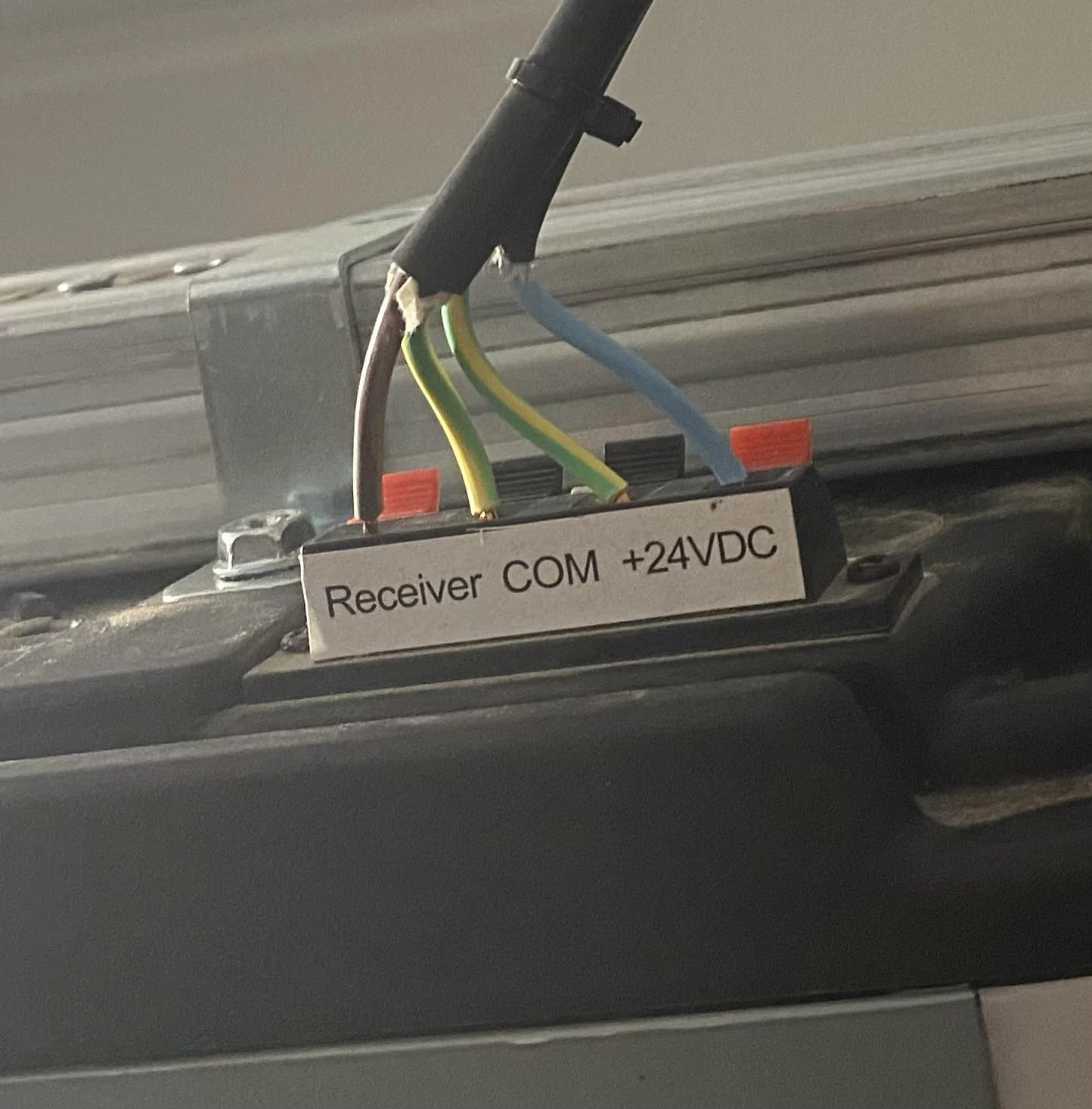

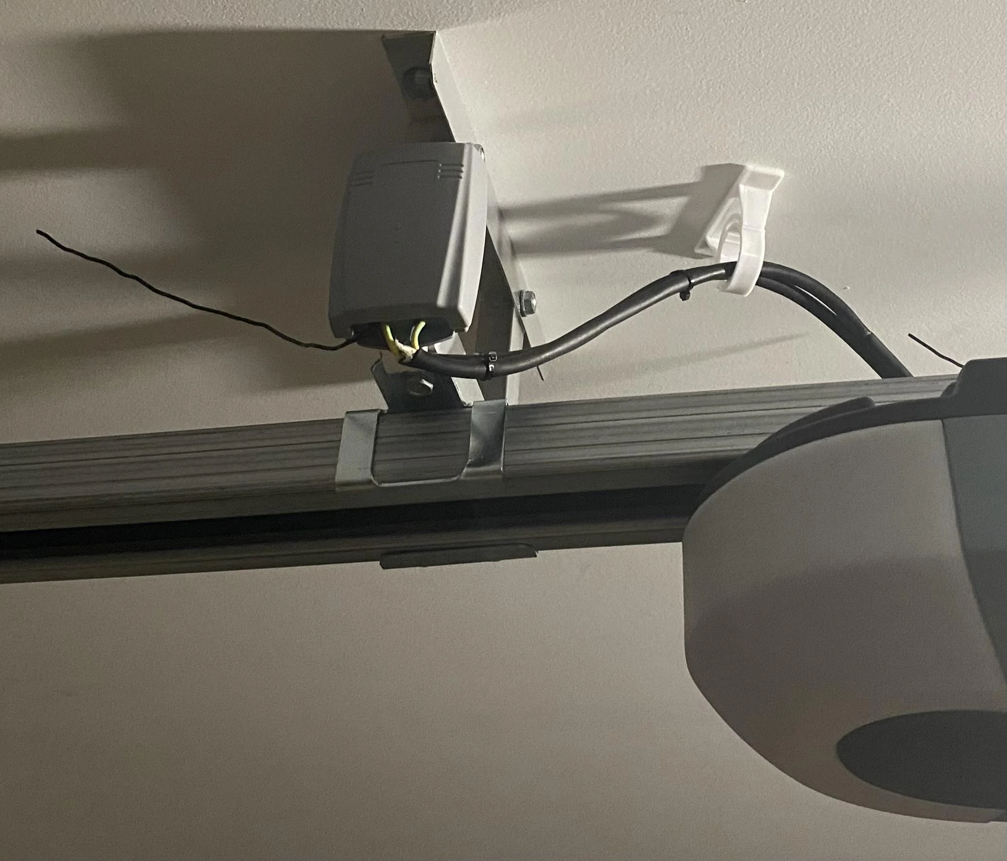

3. I used some spare power cable to wire up the power and receiver screw terminals at the HomeLink box and the push terminals on the motor. Make sure to extend your antenna wire for best range.
