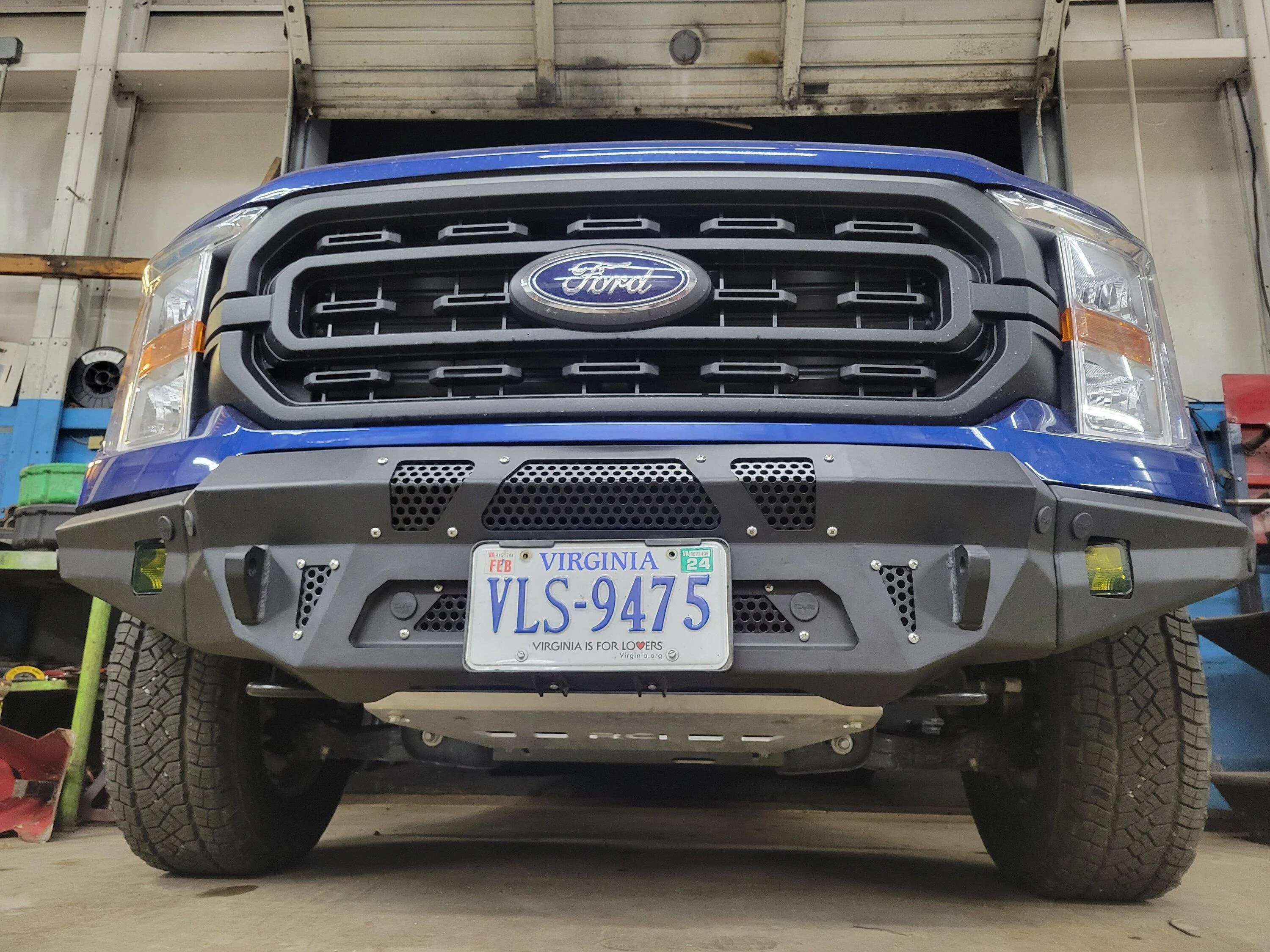

Air bag front impact sensors are not mounted on the front bumper, but on the frame. The airbag system should be fine.
DV8 non-winch on my non-powerboost V8 2022 F-150
Ford F-150 Hidden winch mount (or new bumper) for 22 Powerboost? 20220725_212952
Ford F-150 Hidden winch mount (or new bumper) for 22 Powerboost? 20220725_213022
No Air bag system modifications made.
Great pics, nice truck! I have an XL also and like the base look of them with steel wheels.
I have been debating this bumper in the winch version, vs the Warn trans4mer mount.
-How do you like the bumper? any electronic issues with the Auto Air Dam or anything else after install? i dont have ACC, so not worried on that.
-Did you trim the crash bars in front of the front wheels like it recommends? if so, I assume they were pretty glaring had you left them, given the high-clearance bumper?
-How was the install?

The removal of the AAD on leaves a trouble code, but no lamps. I hope to disable the ADD with Forscan, but have only backed up all the computers so far. There are no forward crash bars on my truck. Install was easy other than a little hole grinding to center it up better. There's plenty of room to fabricate a winch mount, no intercooler since I have no hair dryers. Plus I don't want the extra stick out that the winch bumper has. Love the bumper!
Thanks much, that's great to hear! Well, not so great for my wallet now that I want to pull the trigger on the bumper...
