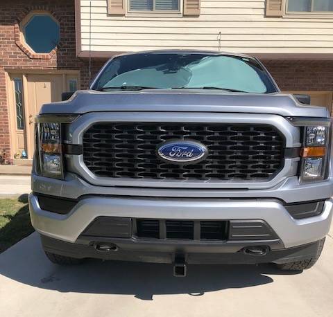

YUP I put on a front hitch as well and am working on a winch I can move from front to back- just need to wire it up- After a BUNCH of years off roading, as Calson said- I never needed it (fingers crossed haha) for myself, usually just to help someone else out of a spot. just a thought for you
