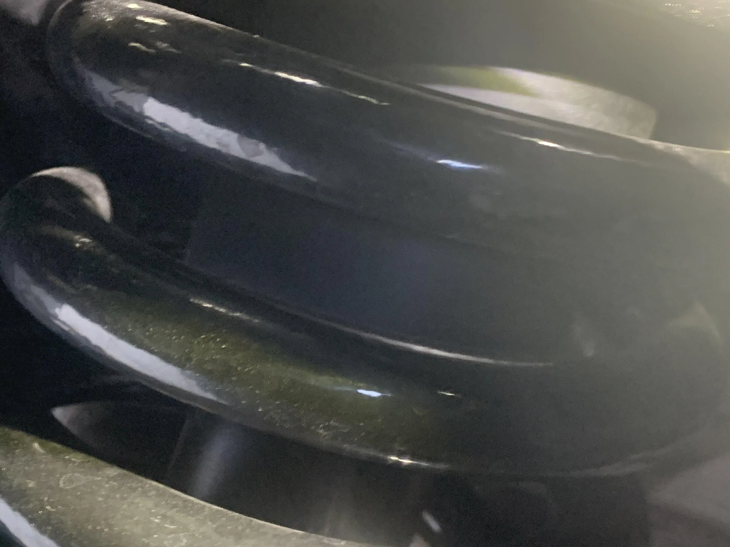

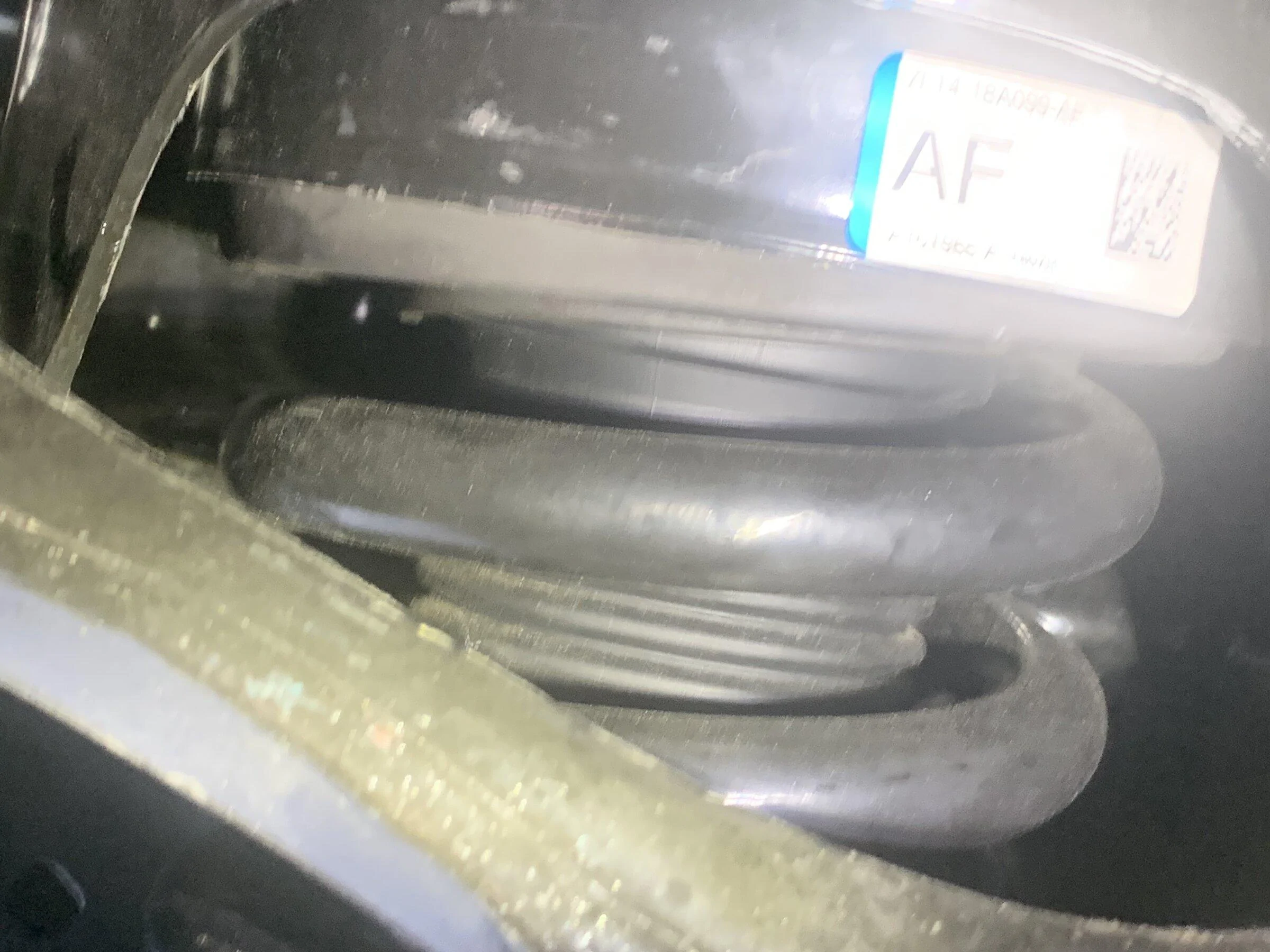

Just did a 2In spacer and Getting a noise when going over the longer speed bumps . If i go 10MPH or less i get no noise but anything over 15 MPH i hear it. I don't think I'm rubbing anywhere as i put the stock wheels and tires back on to see if that made a difference and it didn't. Still getting a lower pitch booming noise is best i can describe it. Any suggestions or even thoughts would be helpful. Thanks guys

My guess is the suspension is bottoming out causing the upper control arm to contact the coil spring. Just my 2 cents.
Thanks for responding!
Anything i should look for when i get bottom of truck or Any idea what I'm hearing when its potentially bottoming out ? I have never had this problem with my 2018 when i did same spacer 2in kit. There has to be somewhere i can see something. Thanks again

I think your onto something!!! Check out these pics. I for sure see scuff marks. Also does the rubber thing in between the spring and space look ok ?
