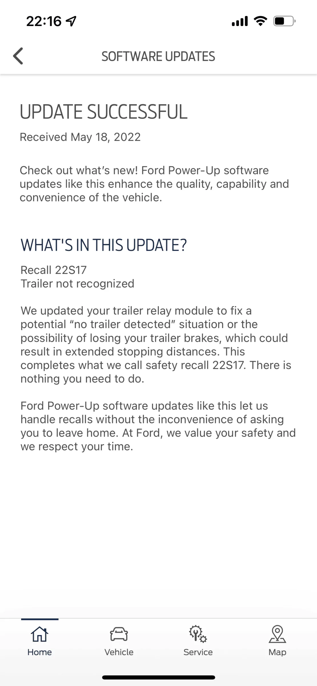

So I fixed the “stuck 1.7.1” updates (and recorded the painfully long YT video) myself, and a major question was whether I’d get OTA updates again without dealer intervention.
Well, starting last week my F-150 has been at the all you can eat update buffet, and got 2 power up’s and just got an update to the “trailer not recognized” recall!
I still have the wiper recall but this was a nice bonus and I’m not sure if Ford updated something automatically or manually on theirside, but in my case OTA most definitely now works.

Great video! Thanks for helping all of us on the forum with that. It's also great news that your updates are working again, and it's unbelievable that Ford can accomplish a recall via. OTA! It's truly a new world in automotive technology.
^^^^ This!
I know because of the Rocky start Ford has had with OTA, we might forget that the whole concept is intended for just these kinds of unheard of capabilities.
It's really amazing when you think about it.

Thanks for the info. Do you know what version of the software was installed?

I received the same notification this morning that this patch was applied last night. Very cool.

Did the OTA fix clear out the recall from FordPass as well?

My dealer supposedly fixed the recall by installing the "BA" software in April. The recall was cleared in Ford Pass a few days later. I wonder if I'll get the "BB" fix OTA after my recall notice was cleared. ?

Same thing here. It will curious to see if we get the new updated version even though the recall does not show up after the dealer installed "BA".
